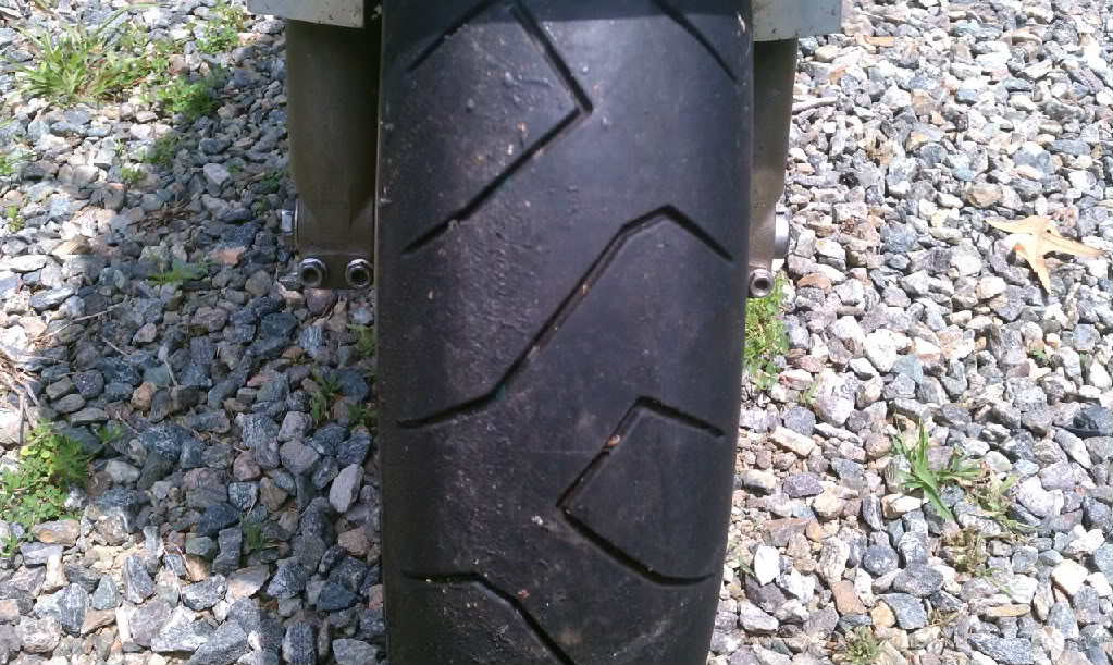

There's something to be said for someone who can build me some forks and, with only a half a turn of the adjusters, make my tire look like this after 3 days.
+1 for Jamie
