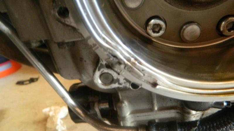

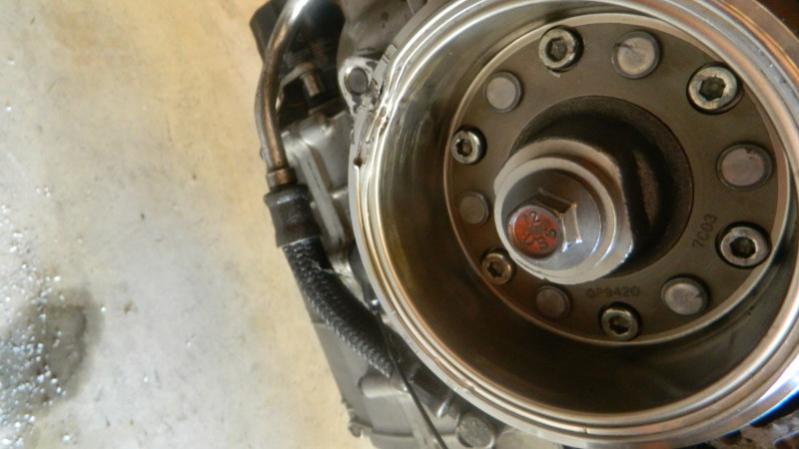

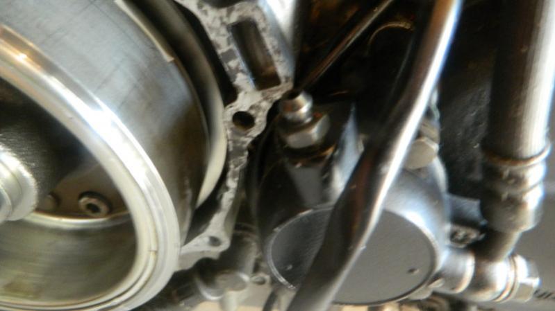

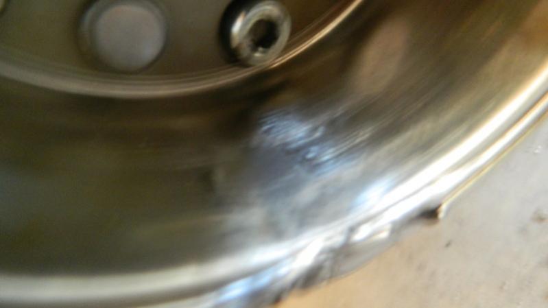

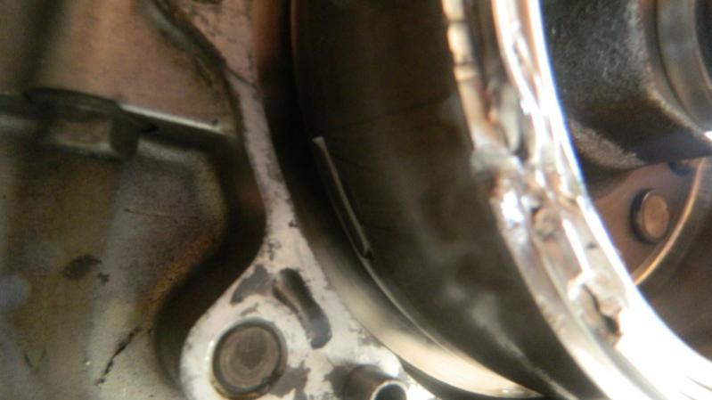

After troubleshooting
After troubleshooting the bike, I looked at the alternator and the bolt looked stripped. I removed the bolt and found that the flywheel was bent and scraped. Im attaching photos for you. Could this be preventing bike from turning on? I also noticed (not sure the name of it) the black divider beside alternator has a missing tube. I will also include this pic. Would appreciate any help or tips!
Attached Thumbnails Engine wont start-dscn2226.jpg   Engine wont start-dscn2227.jpg   Engine wont start-dscn2228.jpg   Engine wont start-dscn2229.jpg   Engine wont start-dscn2230.jpg
Old Aug 29, 2014 | 07:47 AM
Ya that could do it..
Id guess the bike was in a wreck.. cover replaced. and then bike sold as is.
Old Aug 29, 2014 | 07:49 AM
cybercarl's Avatar
Joined: May 2012
Posts: 397
From: UK
Crikey that's taken a bash with a hammer. Looks like it may have been lightened a little too (looking at the last pic) I suspect the damage is from someone aggressively trying to remove the flywheel for lightening. The damage should not stop the bike from starting unless it's affected the iron particles inside the flywheel. Is there a hole there (blurry pic 3)
More concerning is the long term damage with the flywheel possibly being out of whack from a balance point. This would put extra strain on the Crankshaft bearings. You need a rattle gun and a flywheel puller to remove the flywheel.
Looking at the pics again, has the shape of the flywheel deformed into an oval.
Old Aug 29, 2014 | 08:24 AM
You still have to be more specific when you say "bike won't turn on" for us to have any idea of what's going on.
Are there lights when you turn the key?
Is there any clicking or humming when you hit the start?
It could be one of the switches or relays or fuses or connectors, but there's no way to narrow it down.
Yes, that flywheel is bad, but before you disassemble your whole bike, start from the top and it will be helpful if you fill us in. Otherwise, I'm still going to say, start with the killswitch, fuses, sidestand/clutch switches, battery, r/r before guessing any number of mechanicals.
Old Aug 29, 2014 | 08:51 AM
RCVTR's Avatar
Joined: Dec 2005
Posts: 1,689
I'm guessing the flywheel was bent in a crash. A dial indicator on the end of the crankshaft after the flywheel is removed will tell you if the crankshaft is bent. But it sounds like you are in over your head.
Remove the spark plugs, if you can figure out how and see see if the engine turns freely by hand with a wrench on the flywheel bolt.
since the side case was likely broken, the crankcase is most likely filled with gravel, so you need to drop the oilpan and inspect. Running it will be a disaster, but it sounds like the PO already knew that. I would not run it until doing a thorough damage assessment. Hopefully you don't already have an oil pump full of sand.
The black divider is the clutch slave cylinder. The fitting with no hose is the bleed port. It only needs a hose when you are bleeding air from the clutch hydraulic system.

pic 3 shows a big dent in the flywheel
