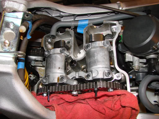

The cam-chain slipped on the cam-sprocket. You will have to take the valve cover off and set it all back up again as specifed in chap-8 of the manual (download in KB sticky). There are marks on the flywheel and the cam-sprockets that have to be at certain locations at certian times (hence valve timing). When you do the rear CCT, be sure to zip-tie the cam-chain to the cam-sprockets to avoid that slippage, and stuff a rag in there in case you drop anything. Also note the position of the cam-lobes in the photo below, both ex and in are fully closed. There is a good KB thread on this too. This should not be all that hard to correct. Good luck. JB
