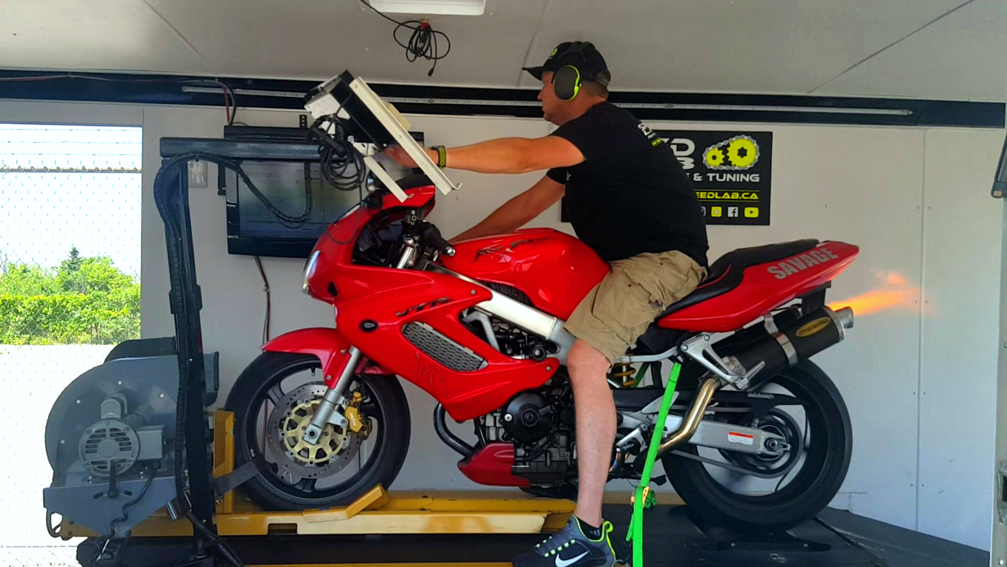

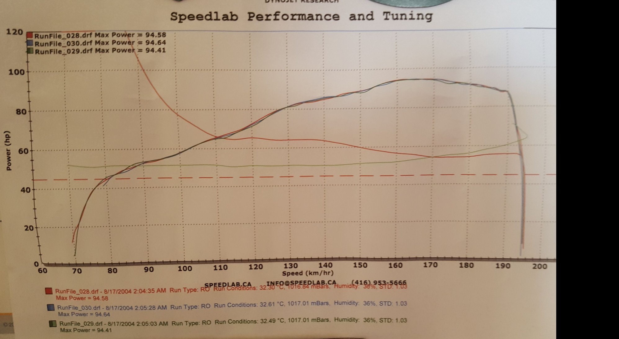

Finally got a chance to get her on the dyno! How did the old girl stack up against yours?

I think you're down a bit on powa.
I thought so as well. Did you do Eriks flywheel lightening? I was wondering if maybe that's why.
Old Jul 16, 2018 | 07:34 AM
OE flywheel. I did carb stuff about 10 years ago and I can't remember what's in there. Before carb work/K&N, it did 108 on the dyno. Before this run, I installed the JF fuel screws and cleaned my K&N, reset TPS. Bike ran perfectly all that time before but now it's unhappy below 4 and my a/f plot shows a bit lean. So some tweaks are in order.
I'm the same. OE flywheel, K/N, I have velocity stacks, Flo commander, I jetted and my a/f is good. TPS. I can't imagine what the 15 hp difference is?

Flywheel weight does not effect Dyno numbers as far as false or different readings. I have done back to back pulls , same day, same part of the day with and without light weight flywheel ...numbers were consistent with only the normal error range anticipated
Dyno to Dyno results comparing are all but useless. Machine, calibration, operator, altitude, weather all effect the outcome.

Yep, I do agree. That being said, in '08 bone stock with just a slip-on:
108ish on a 2 up completely different dyno, different software, yadda yadda.
Then one month ago, my VTR was ran on Koups dyno. I did some carb tweaks not long after the run in '08 and changed to low mount D&D. Only 2 hp difference which seems very realistic.

This one was at a local bike club event. The guy had a dyno in a trailer and was charging 40 bucks(Canadian) for three pulls.

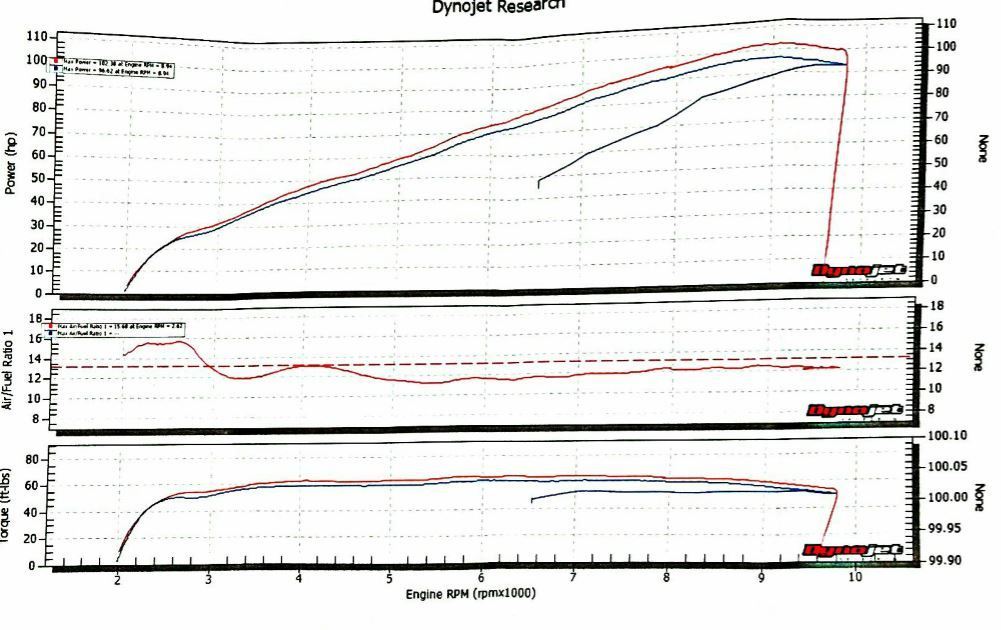

You are definitely missing some HP and the torque output shouldn't drop. Do you have the AF plot? If I have to guess the AF is too lean and the carbs need more juice->bigger jets.
This is mine with Dinojet/K&N (old version)
