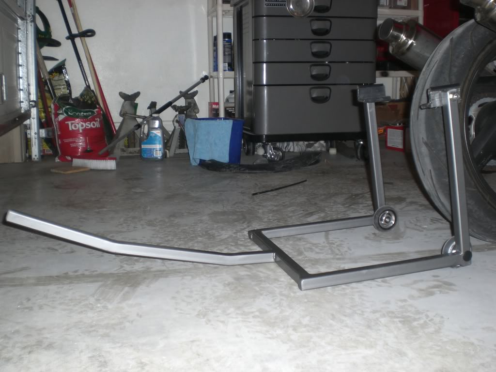

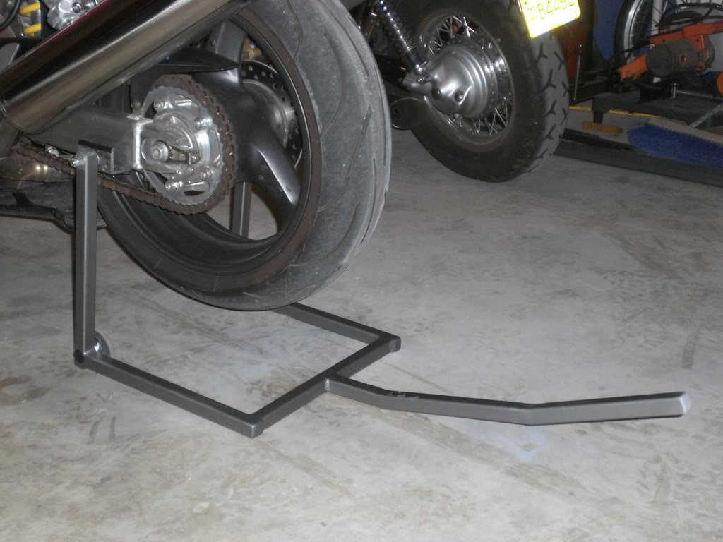

Your on the right track... I've made a bunch over the years.. for my bikes, friends bikes..
Nuhawk has one if I remember right as well.
Im sure there are other pics around as well.
If I may make a suggestion..
Little less angle on the up rights... Handle about twice as long.... consider making the swing arm pads rotate

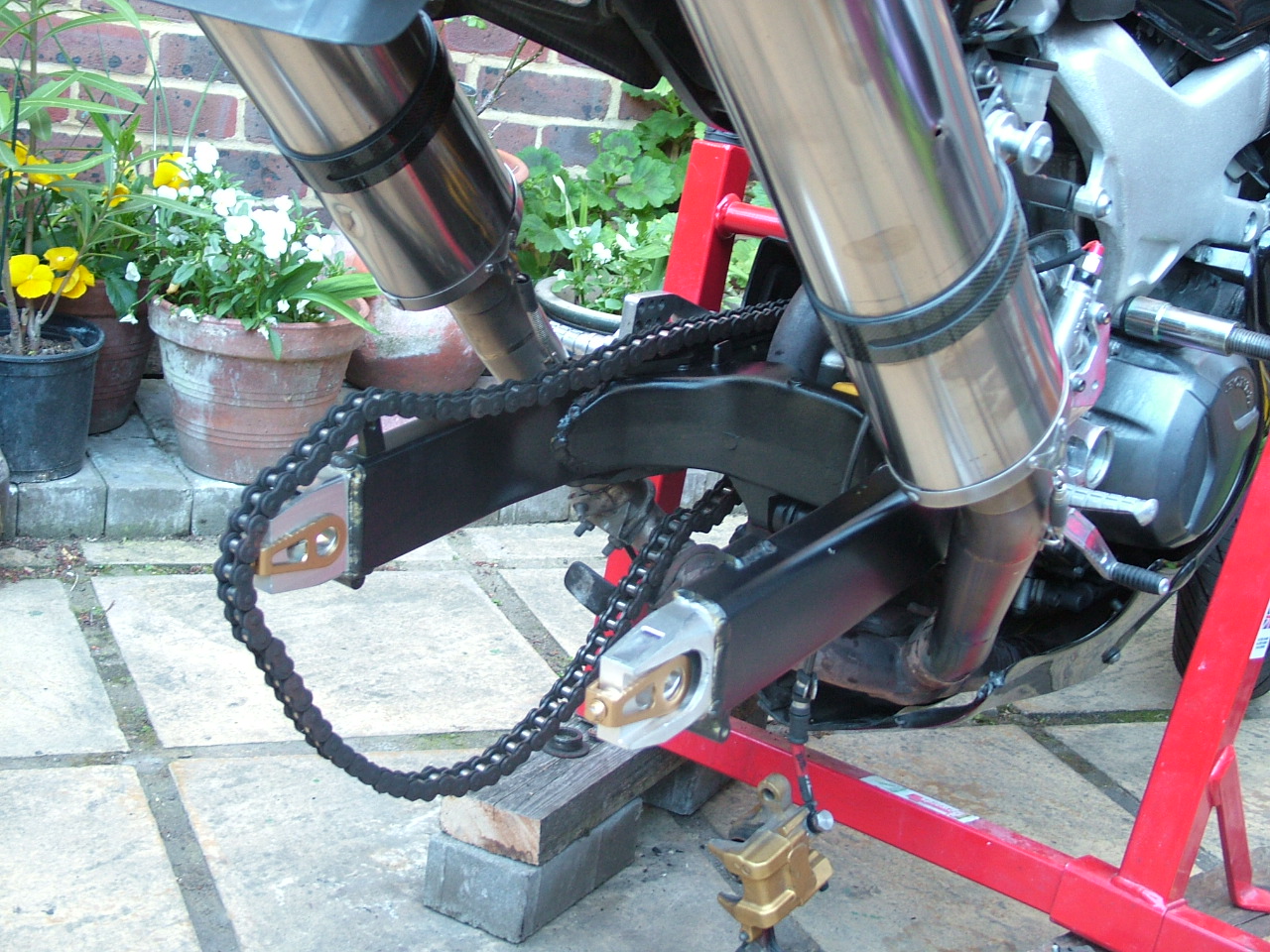

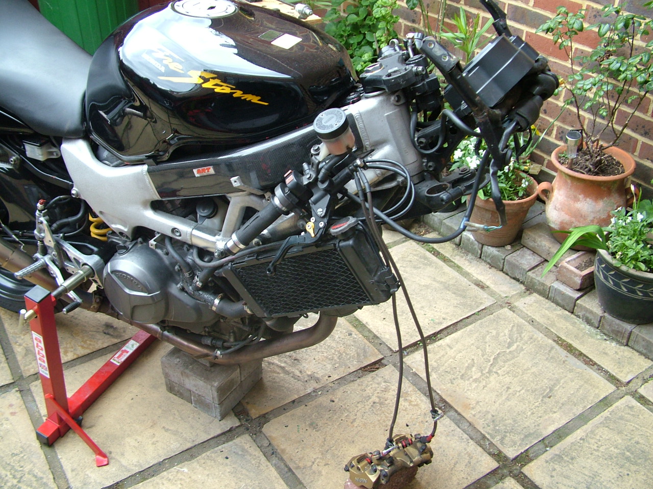

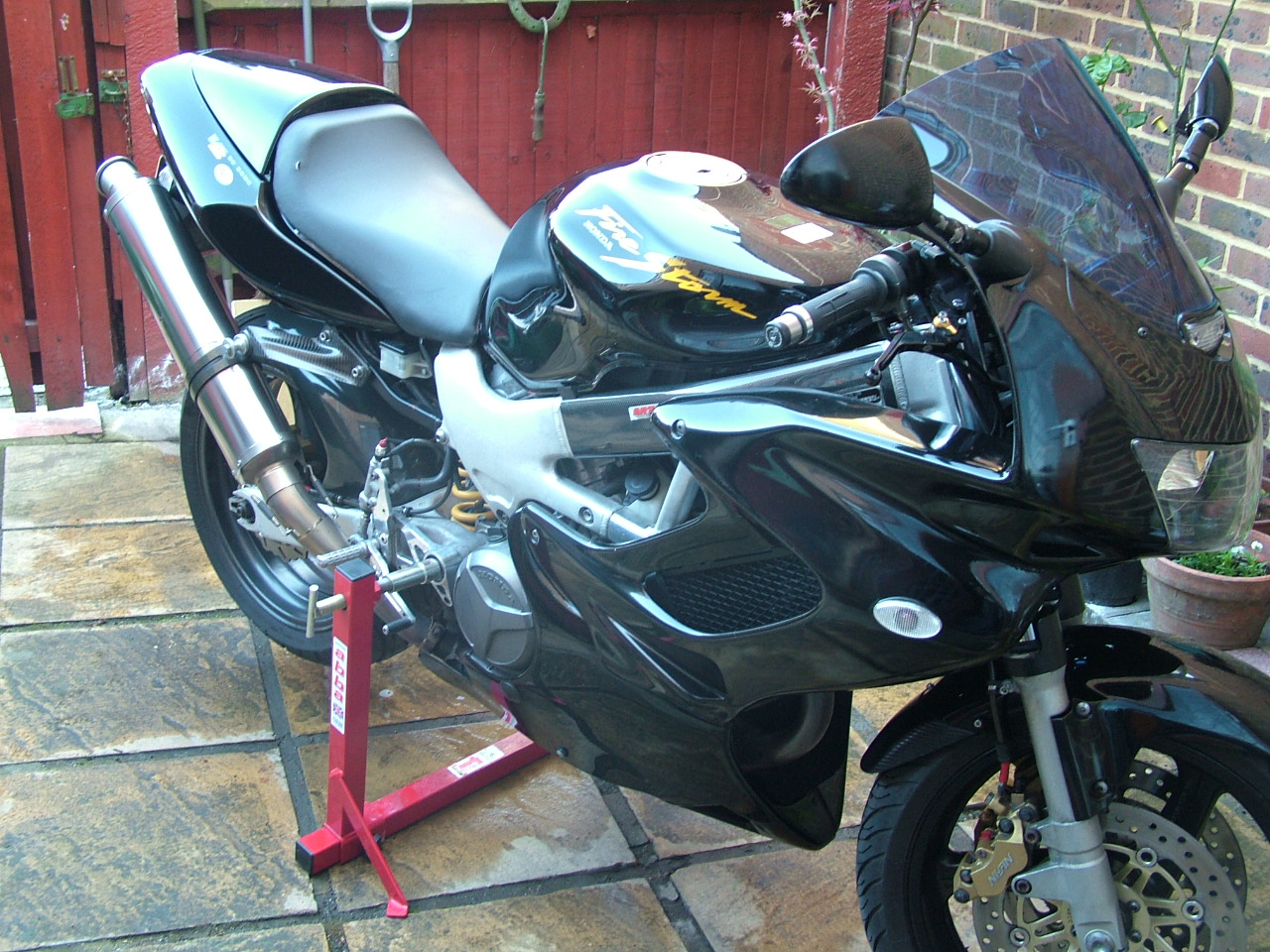

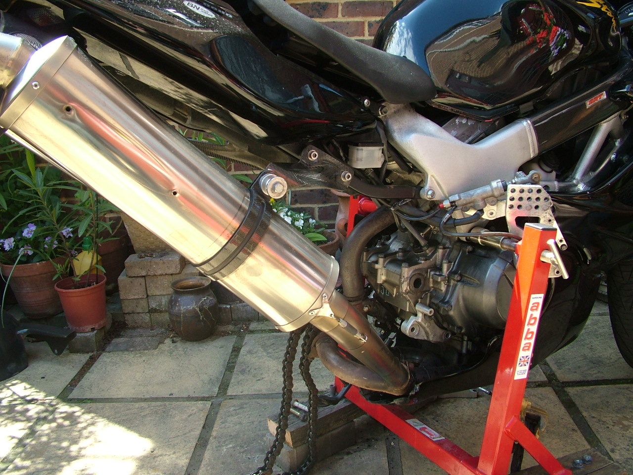

Abba Stands get my vote too. I have a genuine one which like Tweety said is designed to mount of the swingarm bolts. Silly really! So I have mine adapted to mount of the engine mounts. The downside is that as mine is not designed to mount from there I have to sit it on some timber to raise it up a little. With your skills you could make one the tight height to begin with.Motorcycle Stands - Abba Stands, UK
