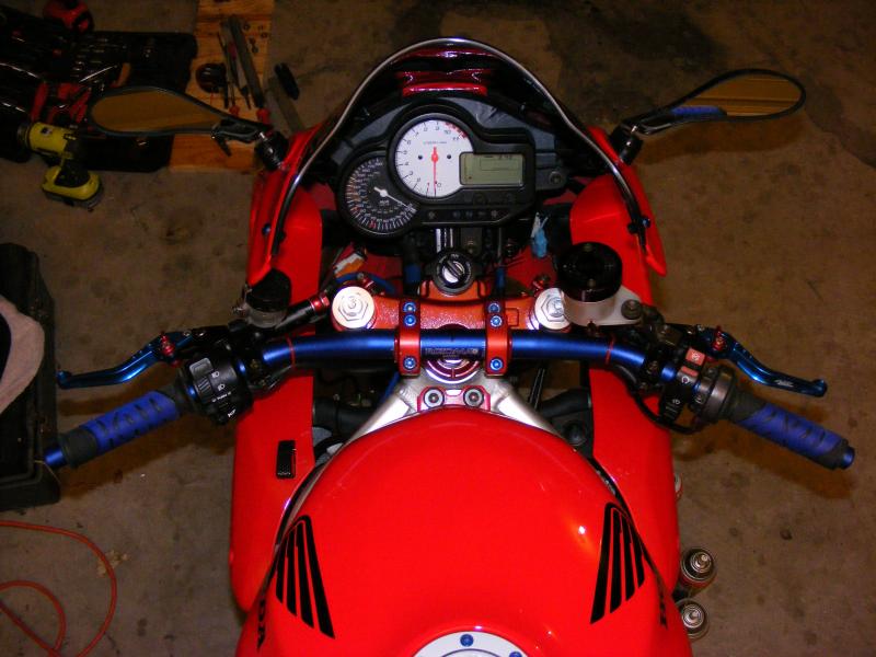

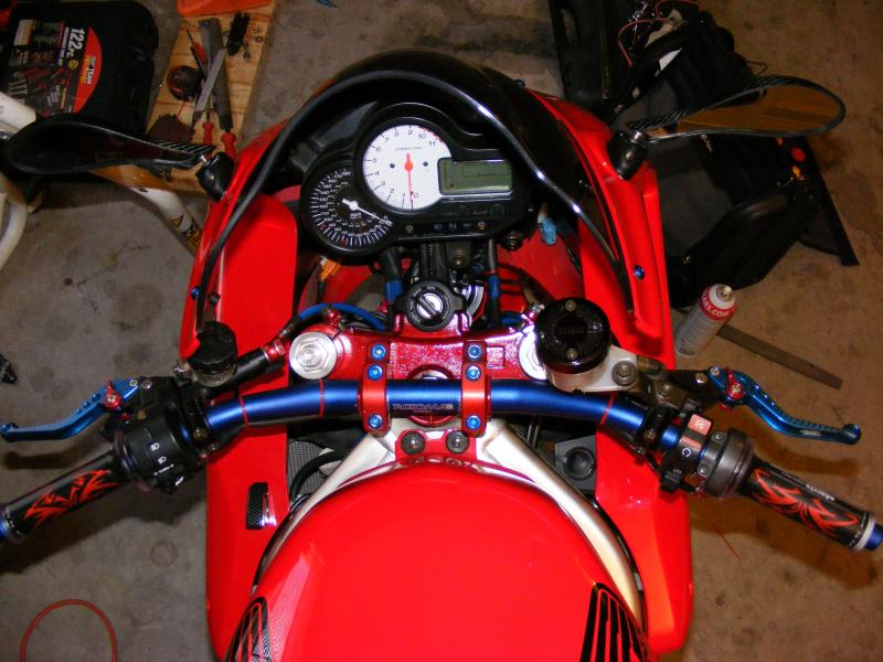

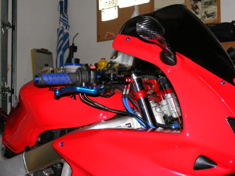

Not alot of plastic to remove if done right, & not too much of a rise needed.
did the superbike bar mod, few years back, & glad of it.
completed, grips 3 in. up & 2in. back. Just had to shave off a little plastic to clear the resevoir.
First off, that looks awesome.
What risers did you use?
I see you have aftermarket brake lines, did you have to extend the clutch line/ throttle cables/ electrical wires?
Hey there Insulinboy, yes drilled the yokes. Two holes required for the risers made by ROX. The ones i got, are inch up & one back. The bar i went with. is from Rizoma. It's a fat bar, with minor sweep back. Underneath the yoke, i used oversized washers to spread the weight. Also used lock nuts to secure the risers to the yoke.

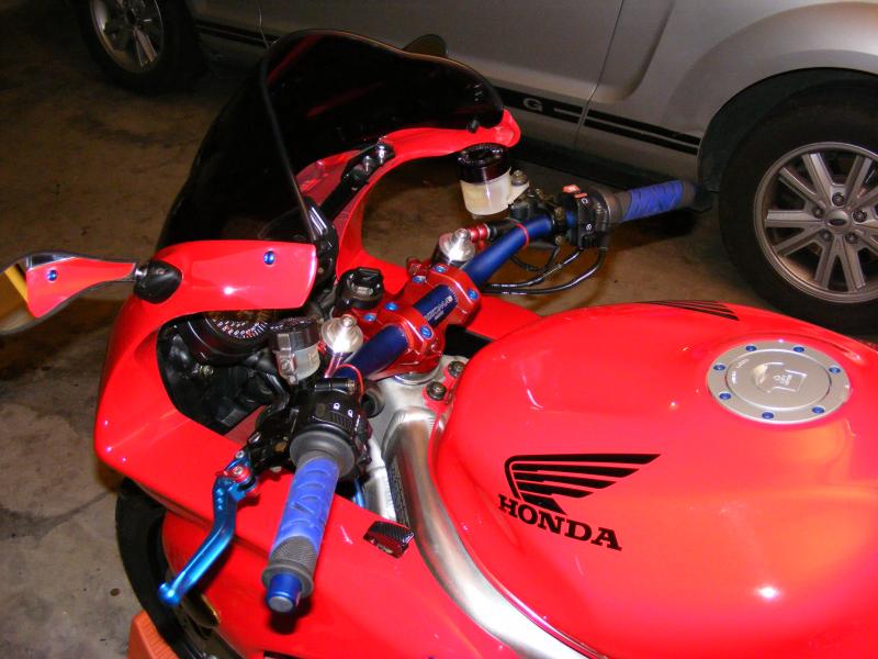

wizardofboz,
Yea, the lines brake & clutch are Speigler, & 3 in. longer than OEM, which was needed. Already had the lines before making the bar mod. Bars made a world of diference. (at my age anyway) I'll include some more pics that may show grip location better. All wiring was ok.
