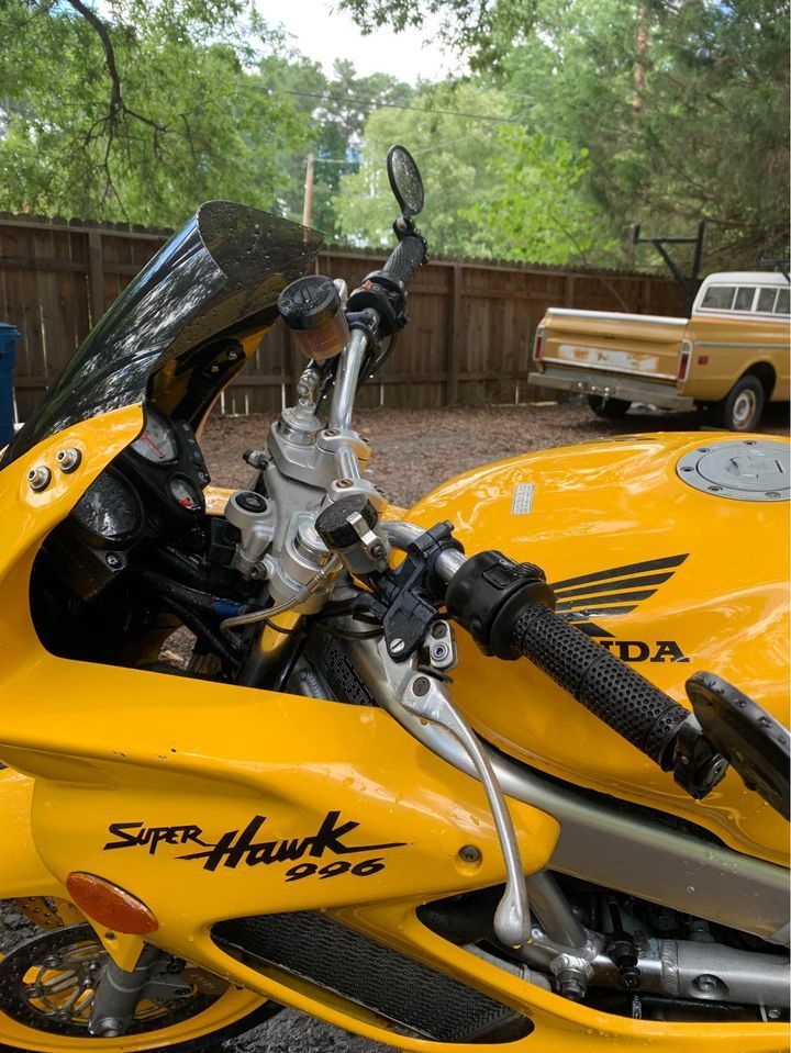

I love this bike, and I would love to have one, but I absolutely hate the riding position. It puts way too much of my upper body weight on my arms and hands. Is there a different set of handlebars available for this bike that are both higher and back further?

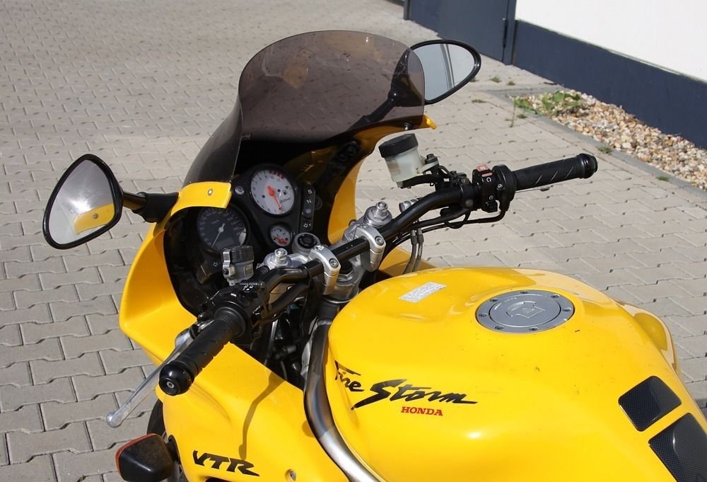

I went with the LSL kit on my bike. Kit includes longer brake and clutch hoses. https://spieglerusa.com/controls/han...-kit-4284.html

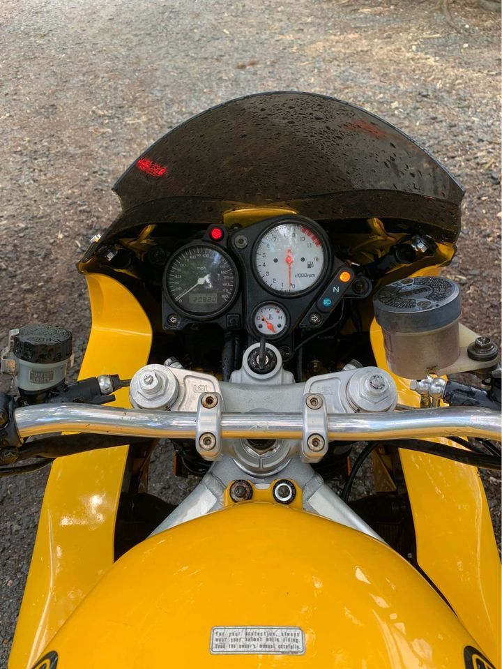

For the bars,if you didn't already notice, the photo of the yellow SH has had the fairings and wind screen cut. To get any where close to an upright/sit up and beg riding position the fairings will get in the way.
Another option would be Bars from a 90'-'05 VFR. No cutting of the fairings. It's an improvement, but it's still a somewhat aggressive riding position. All this old stuff is getting harder to find.

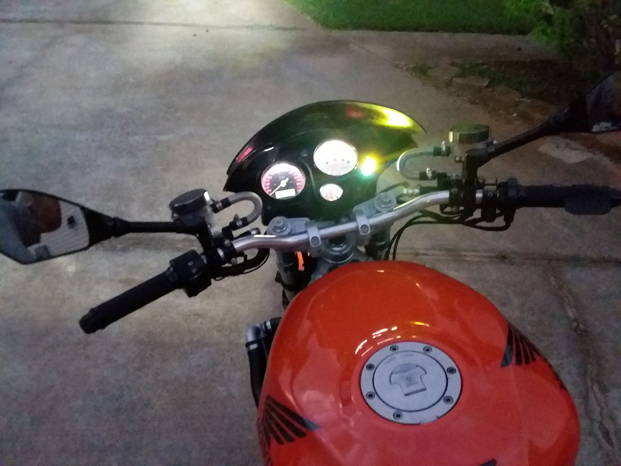

Here is another option. What I am currently using. Wow have the prices gone up!
