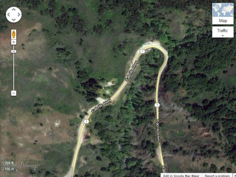

1: I know that road and corner as well as any.. Lived in Monterey for 5 years (Fort Ord) and was on HY 1 daily... best times of my life.
I got run off the road by an Mazda RX7 near the same area as you.
Nice right hand sweeper (heading south to San Luis Obispo) Old dude basically drove straight though both lanes of the corner...
2: Your underestimation how little force it takes to twist the fork tubes in the triple clamps, and no, the axle will not hold them straight and aligned.
Twisting in the clamps is so common, it's really a 100% assumption any time the broke it's something it was not supposed to.
3: The observations and suggestions on race tire take offs are spot on as well.

Haha how weird, I live in Slo. That is the exact corner, right where everyone parks to hike that trail. I will definitely have the front end looked at, I'm getting new oil and seals put in next week so I will make sure to have them inspected thoroughly.
