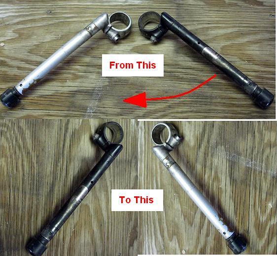

Is it possible to take the right clip-on, rotate it 90 degrees to the left and mount it on the left side (and vice-versa)? This would bring the bars an inch or so closer but I'm not sure what it would do to the other angles.

Probably... But you will then pinch your hands against the tank, and likely make dents/marks in stuff...
Why?!

I was just thinking it might be a very cheap way to move the bars back a little. Helibars and new brake lines aren't in the budget right now.
Why?!
he could adjust the steering stops to prevent that. you'd have to see how much it reduces your turning radius...
You went to all the trouble to take everything off and take pics. Why not go the extra yard and try it and see what you think. It might work.

Galaxieman has the stock clip-ons for sale and had the picture in his posting. I simply took some liberties with his picture. I will keep an eye out for some VFR bars on ebay. Thanks all.....

I know you can do it with woodcraft clip-on's. my local shop guy did it for me without me asking thinking he was doing me a favor. personally, I like the lower sportier posture. not looking to sit up any straighter, so I changed them back. but it did work. probably work for stock too since I think my woodcrafts have the same angle as stock.

OK, sorry about that. To me, it looks like it's worth a try. Visually. it appears doable. Maybe I'll give it a shot this winter. I have mine pulled back and up to top now, so I've been experimenting a bit.
If I recall correctly this mod can be done on an RC51. Is that why you ask?
I was looking at mine tonite and i don't think it'll work. It looks like the MC's (frnt brake and Clutch) might get in the way.
