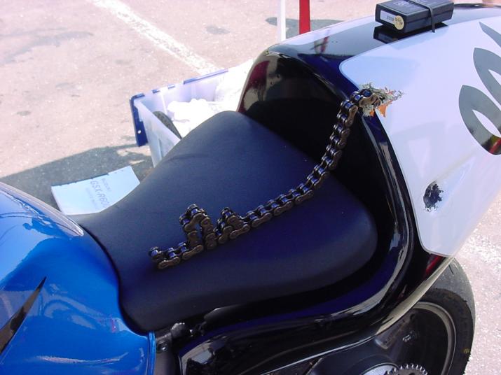

I use an RK set myself. As for clip on links, well some folks say they are fine but you do take a chance of a few problems if they come off.....
Chain breaker/rivet tool - What do you recommend-broken-chain.jpg

skokievtr if you have personally seen a failed c clip master link, I would love to see pictures if you have um...and tell us how it was installed, using what tools, pic of the installed link,or what ever you have... Thanks
