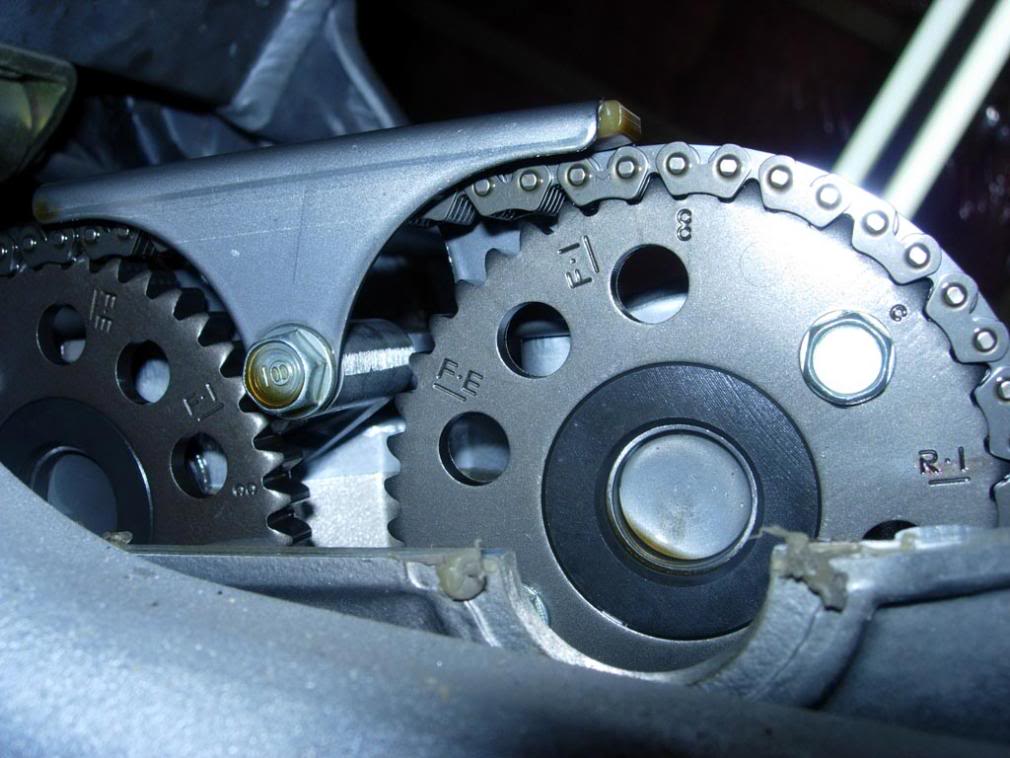

Along with what Tromo said, does anyone have a picture of the rear cylinder at TDC and the cam cover off showing the position of the exhaust and intake cams?
It looks like the failure was caught in the nick of time and it seems that the chain only jumped when the rear CCT failed. As Tromo said we pulled the head and there appears to be no damage to the piston or valves.
I read through the threads about CCT failures before Tromo and myself dug into the bike. So any pictures or information about positioning the cams/cam sprockets would be much appreciated.

I have been meaning to put the new walk through up, Im glad we took tons of pics. I think this is the pic you are looking for, this is the correct position you want the rear lobes to be at when at dead center when installing the rear cct.

Yruyur that is exactly what we need for a visual.
Many thanks!

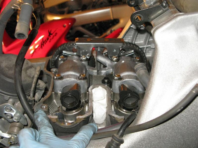

Shiat... take the front plug out, put your finger in the hole, rotate engine couterclockwise until you feel compression, check for FT mark on the flywheel, pass it by 3/4 of a turn to RT, align the mark perfectly, then set your cams sprockets like this

The RI mark should align with the top of the case on the intake cam, same goes for the RE mark on the opposite side toward the rear

thanks gboezio thats exactly what i needed to hear...

np prob, make 2 or more full engine turns when you're done to make sure the valves clear the pistons before using the starter, then if you made a mistake it will just consume some time, not money
