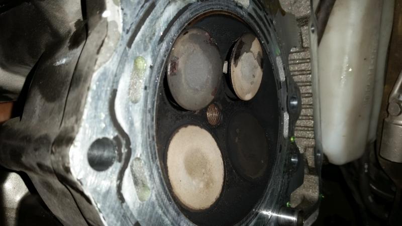

Got the head off and this is what I found. Piston appears to be fine. Exhaust side valves are bent. What is the best approach to fixing her ?

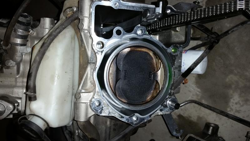

Picture of piston

I'd buy a good used head, gaskets, new CCT and reassemble and go and
