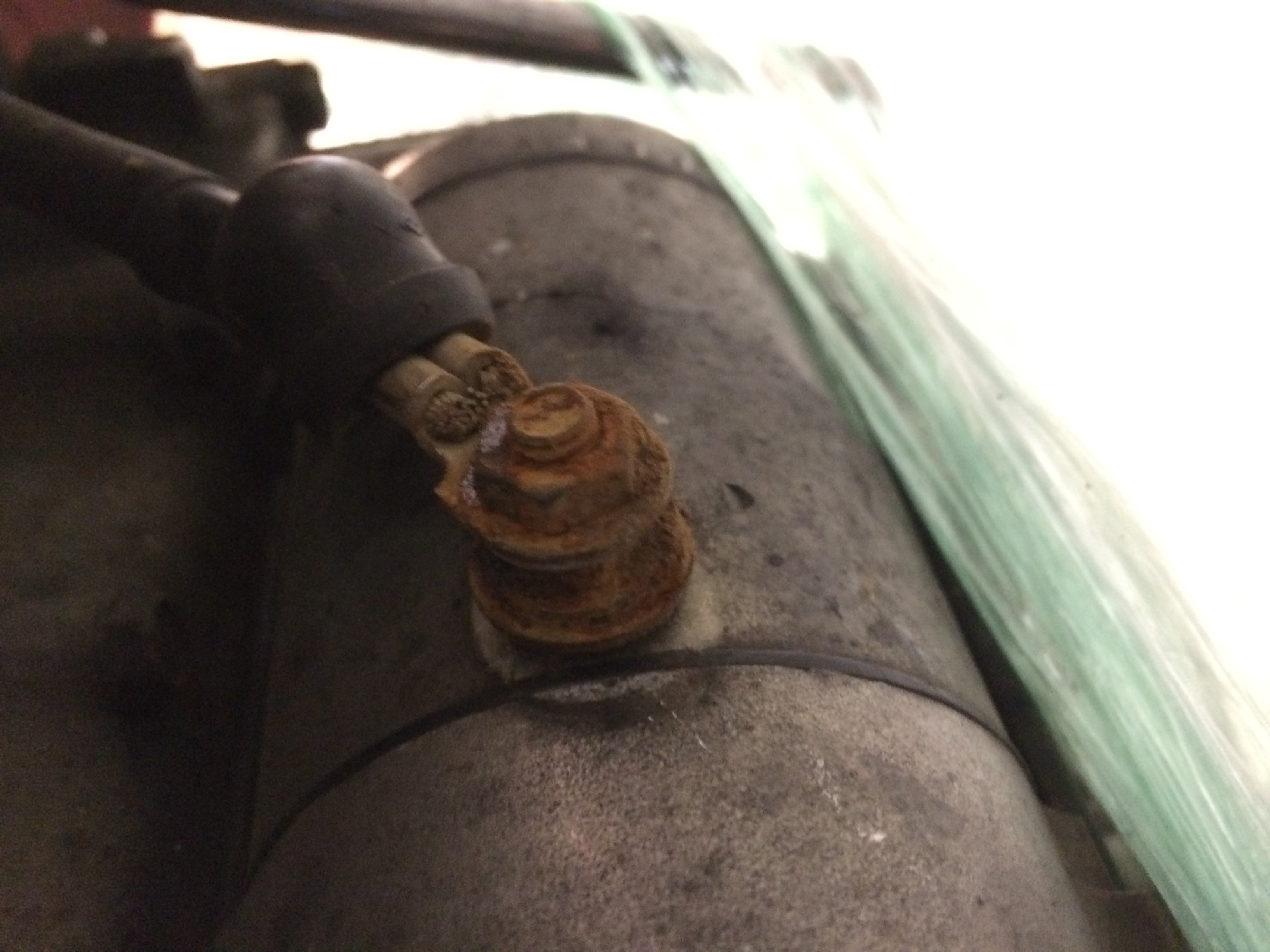

So i went to pull my starter off today and found extremely rusty nuts under the rubber boot (the nuts that hold the starter cable on).
I had to use an impact to get it off, but i failed to hold the stud properly and i cracked the plastic ring inside the starter housing.
Anyone have one of the plastic ring pieces?
(Note: check under your rubber boot and clean this connection!)
James

The nuts under the rubber boot require maintenance if you hand wash your bike or ride in the rain.
I found out the hard way like you. I check mine every couple of months.

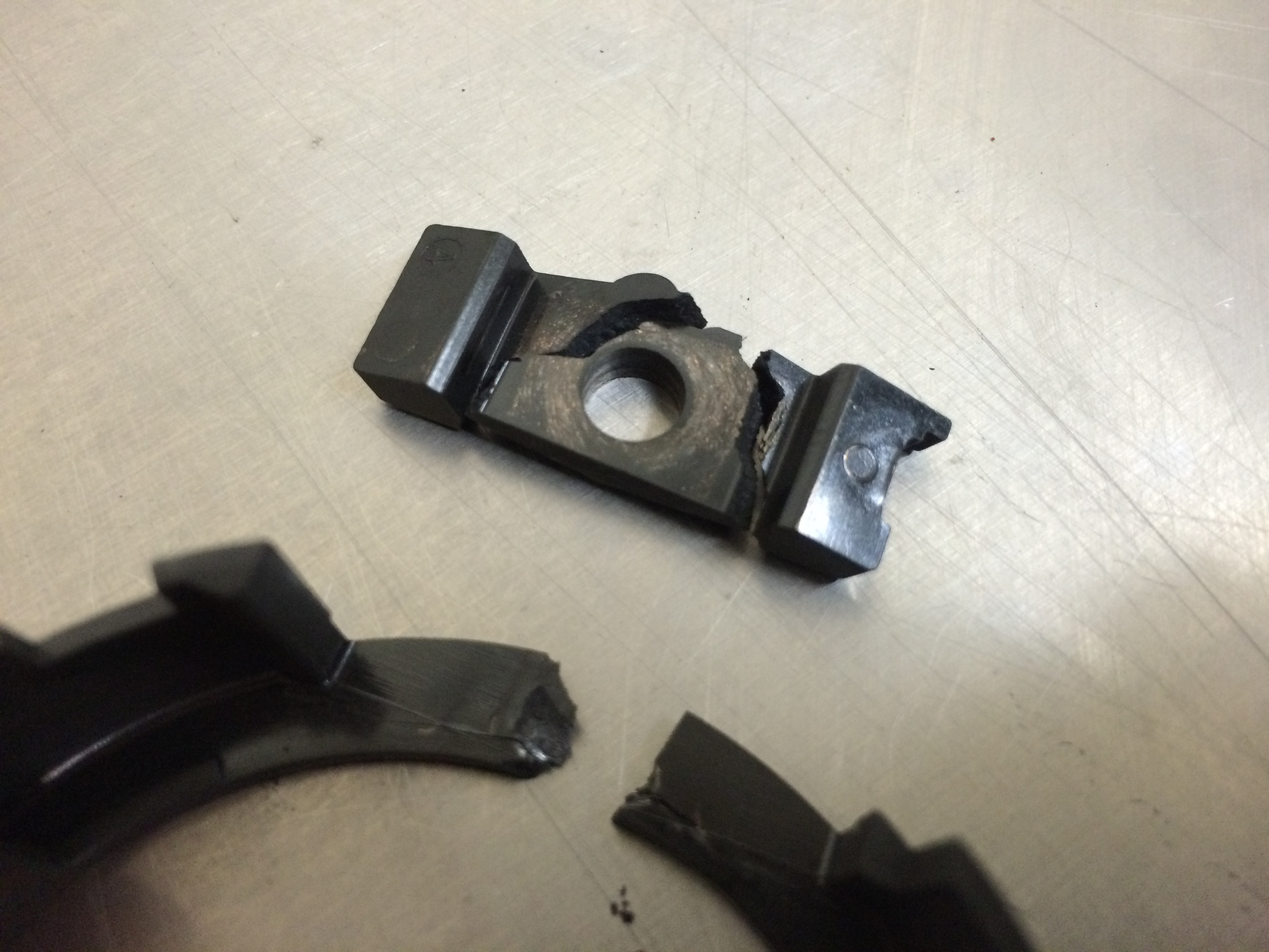

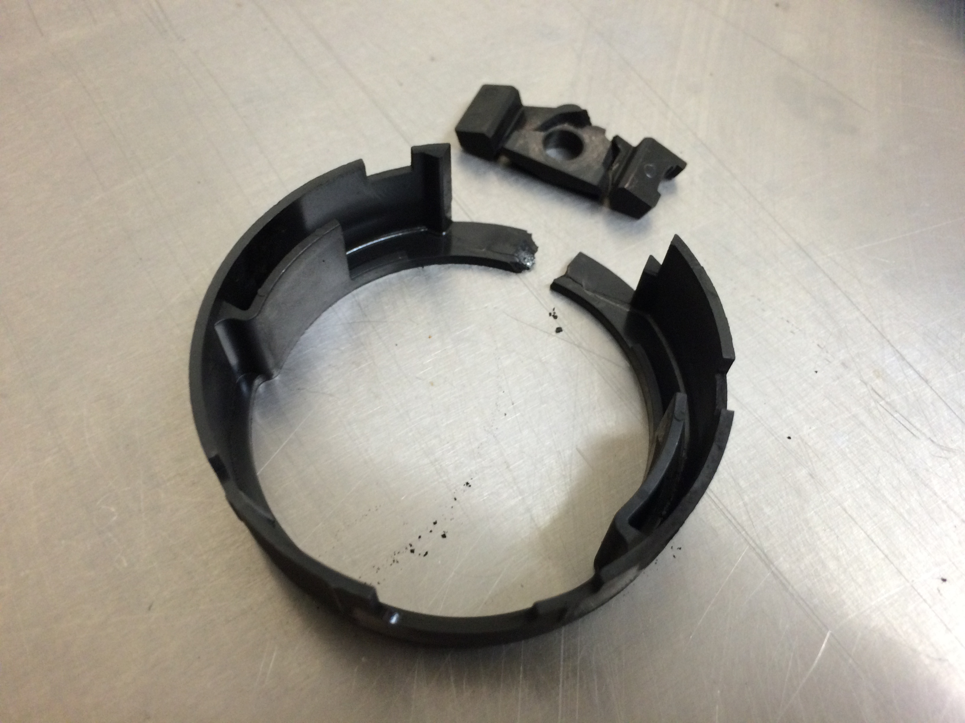

Here are pics of the two pieces i need. If anyone has a busted starter and can part with these pieces please let me know.
Thanks!
James
Old Jan 3, 2016 | 05:29 PM
thedeatons's Avatar
Joined: Feb 2013
Posts: 1,510
Another pic of the pieces.
James

Still looking if anyone has any internal starter parts they don't need please let me know. I do not need a whole starter, would prefer to just get the parts i need from another member here.
