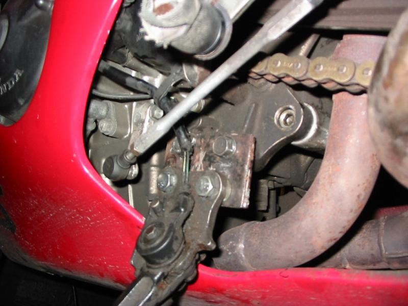

My partner needs lower pegs, anyone using lowered pegs for the pillion?
Old Oct 17, 2014 | 08:51 PM
I have only seen them spaced out more to give room for high mount pipes. (you just use spacers).
You need to get a peice of plate steel and just drill 4 holes to move them down.
Same as I did with the sidestand in this pic but you may want to make it prettier since it will be seen.
Do it out of steel, they can be under some real weight and you REALLY dont want them to break.

I had thought of that. I do wonder if it would stuff up the pipe mount positioning. Have seen it before on Bandits.
