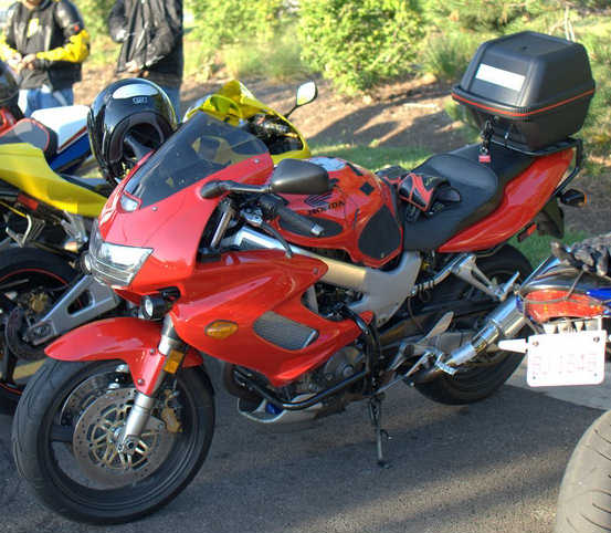

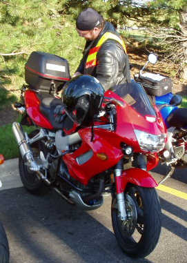

Long before the FZ1 came out I had already grafted R1 mirrors to Don Herve's beautifully billet machined and black anodized VTR mirror entenders.
See below...
Attached Thumbnails D2 moto lowered their price on FZ1 mirrors - !! (And I have a ?)-vtr-2.jpg   D2 moto lowered their price on FZ1 mirrors - !! (And I have a ?)-vtr-1.jpg
