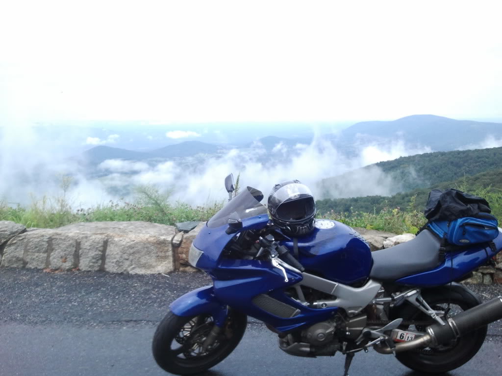

Oh, and here's a picture for you to enjoy! On top of the world, skyline drive, in Virginia U.S.Name:  2012-08-19135531.jpg

WOW ... What a view... What is the altitude there???
This is at 3,200 feet above sea level.

there's a skyline drive in Northern California, too. Not sure of altitude but is likely to be 1000 to 1500 feet above sea level. Much the same view and twisty roads. Wish I could offer suggestions on your problem. Nice looking bike!
