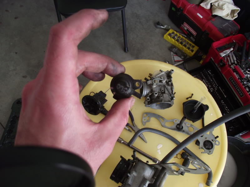

Tore into the rear carb tonight just to do some cleaning and found this in the bottom of my diaphraghm.
Now I know the carb set up thread says to plug one of the holes and that if there were three holes found, then that means there was a jet kit done at one point in time.
The rest of these pictures are just me cleaning up the outside. I'm not going to rejet the carbs yet as I think I'm going to buy the Kiyo Watanabe set off his site. I got to get a hold of him first though. Haven't been able to make contact.
What is this thing?
Well Kiyo is a good guy but a lot of the parts on his site are no longer available. If you do end up getting a HRC kit from him, let me know and I'll tell you how to set it up but you really won't be using very parts out of it.
Also make sure you get a set of stock slide springs if you do get the kit.
Though for a basically stock engine just buying a set of stock needles (they are different from front to rear) some slide springs and a pair of stock jets will give you good results for a lot less $$

So which needles are you running? do they have adjustment clips or are they fixed length?
Aslo it looks like someone plugged lift holes but left the short dynojet slide springs in place, which can give some strange results.
I do have an adjustable needle in the diaphragm but I left the retaining ring in the same position it was in I just put a washer underneath it. I set the carbs up exactly like you said to do in your write up.
The pilot jet is a #48 and there was another jet that is set on what looks like a 10mm screw that said 183 on it. To be honest, I'm not entirely sure what that means.
As far as the slide needles, what are your recommendations to help to NOT have those strange results? I just want to ride this season and this winter I'm going to delve into it much deeper.

That's the main jets. You want to set those at 175 in the front and 178 in the rear.
Well then you really haven't set them up according to the thread I wrote.
In order to actually set them up according to my thread you will need needles, slide springs and main jets.
What you have now is a DynoJet kit. Which is designed to open the slides faster. IMHO this is not the way to go, as i stated in my setup instructions.
So just plugging the extra lift hole (or holes for the front) you will get unknown results with the large main jets and the lite slide springs.
If you actually want to run the setup I wrote, you will need a stock set of main jets (175front, 178 rear unless you are at or above 5000' feet altitude then you run 172\175 mains) a stock set of needles and a pair of stock slide springs.
Otherwise you are experimenting with a unknown set up.

Well than that's good to know. Now I know to get a stock set of needles this weekend. No worries everyone, she'll get set up right. I was lead to believe this bike was stock so its good to find out that it's not.
