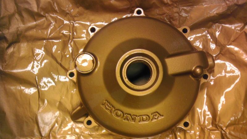

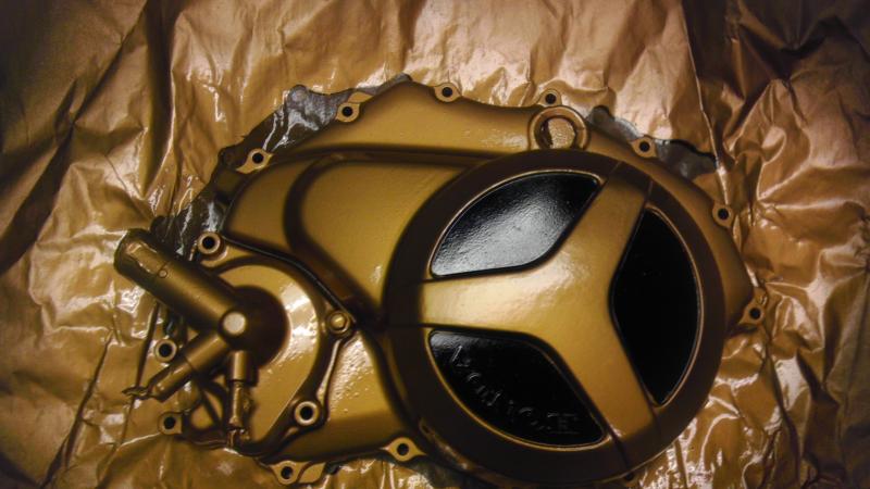

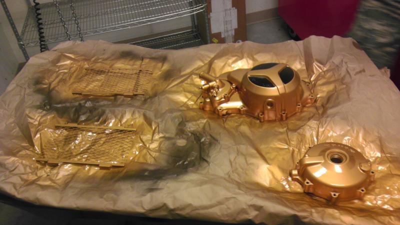

Here are the pictures of the painting I have already done. Yes I know the clutch cover has some serious flaws in the paint but this winter I will be getting it sandblasted and will redo the entire thing. For now, I'm just REALLY itching to ride this thing!
Attached Thumbnails 98 SHawk Renovation-crankcase-cover.jpg   98 SHawk Renovation-alternator-cover.jpg   98 SHawk Renovation-crank-cover-both-rad-grills-alternator-cover.jpg   98 SHawk Renovation-radiator-grill.jpg

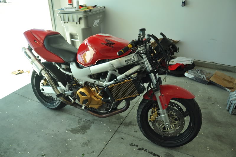

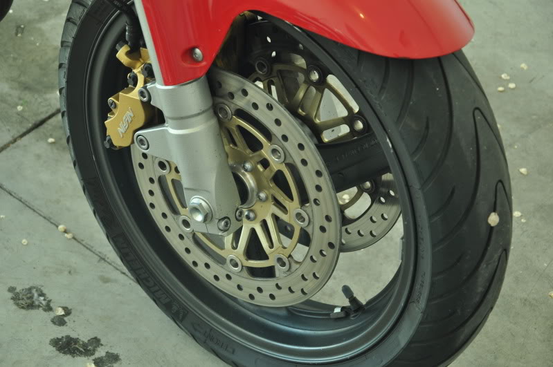

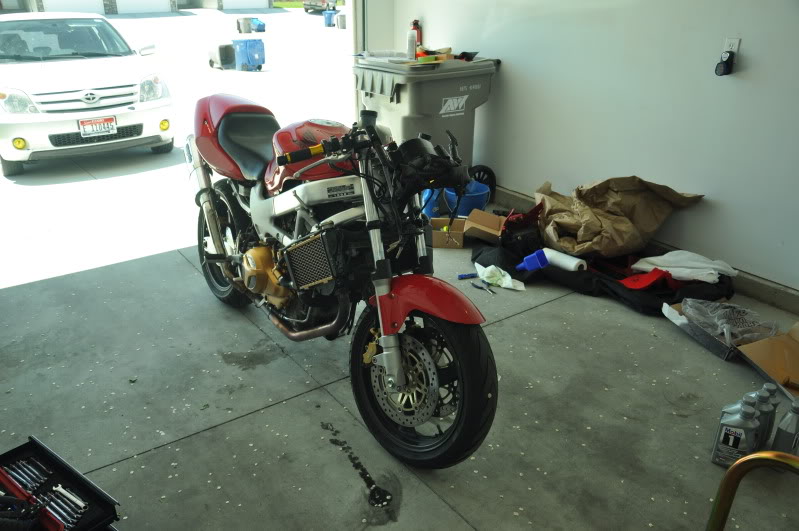

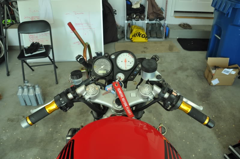

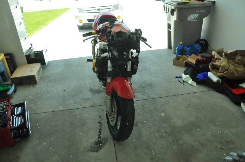

Ok so here are some pictures of the Hawk as it sits right now. Keep in mind that I've painted the covers, lined the tank, put in a new fuel filter and slapped on some new grips.

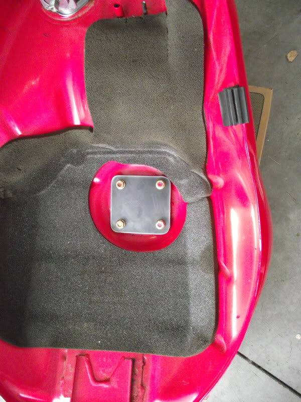

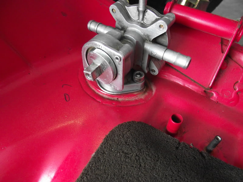

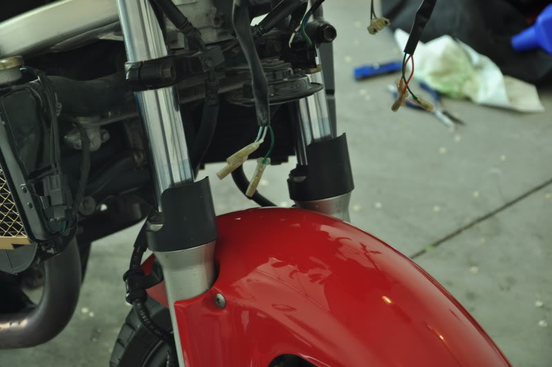

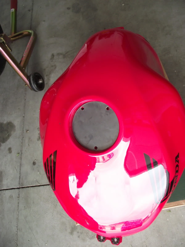

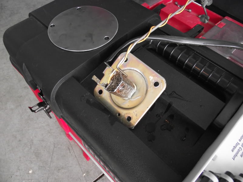

These are the block off plates I ended up having made so the paint on the tank doesn't get ruined by the acetone in the cleaner I used for the liner.

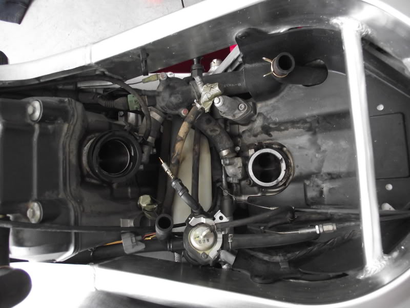

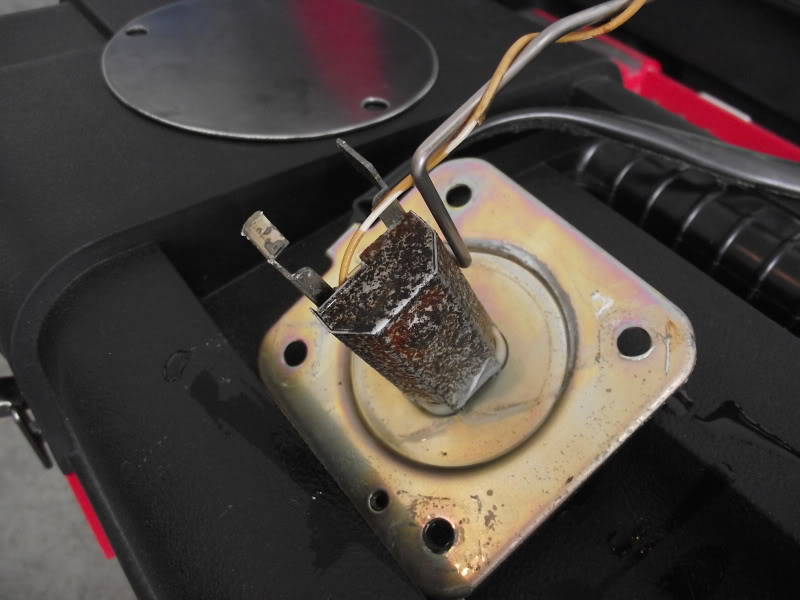

As you can see here, even the fuel sending unit had some rust on it so I dunked that in the cleaner too. Luckily (even though I know I took a gamble) the wires didn't get ruined by the acetone.

Old May 25, 2012 | 12:46 PM
Originally Posted by JN607
Yeah I did that. I know I did that. I had labeled everything to make sure that everything was in the right place. Could it be that the carbs may need cleaned? There was rust inside the petcock too so I believe there may be rust in the carbs?
Yeah with that much crap in the tank I would say they should be pulled and cleaned.
It also gives you a chance to see if anyone has done anything to them or if they are stock, so you know where you stand when trying to get them dialed in.

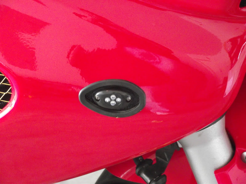

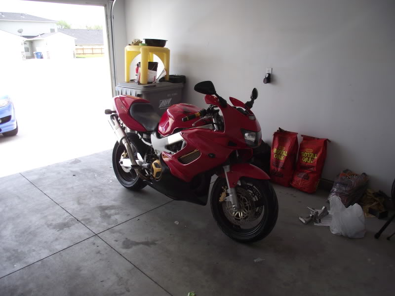

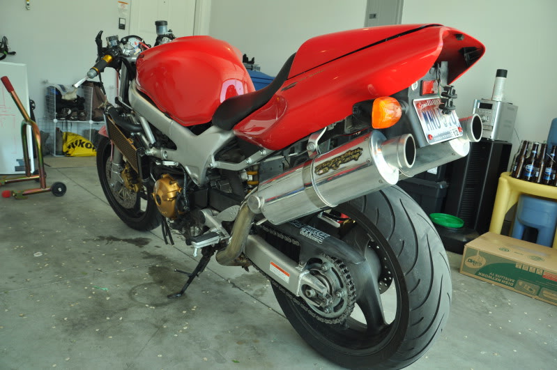

Thought I would put up some pictures of the finished product. Got the right side fairing and the belly pan back from paint yesterday. It looks alright for a 150 dollar paint job. It looks like orange peel up close but it looks a lot better than the huge gouges that were on it.

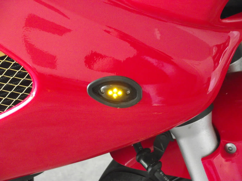

These are the flush mounts I got. They're from PKM Kustoms. They look pretty clean if I do say so myself.

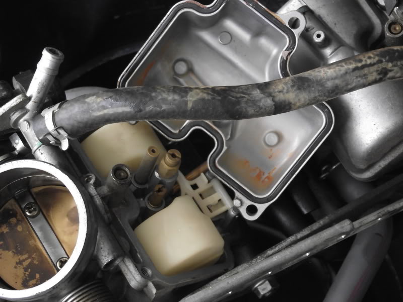

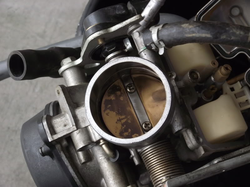

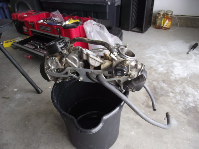

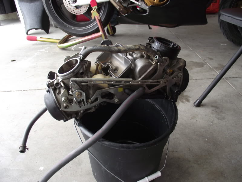

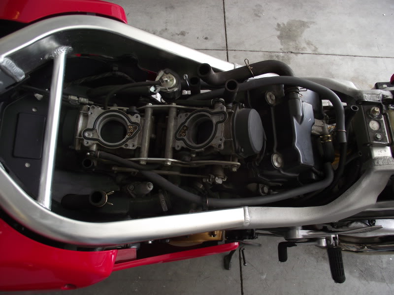

I tore off the tank to do the carb cleaning job today and found that they are a B****h to get off so I was wondering if any one had any tips on how to get them off easier. I sprayed some wd-40 where they clamp on to the boots to try and loosen them up and that helped a little but I'm a little guy and I don't have much in the way in muscles. Hah, anyway, any help would be fantastic.
Old May 27, 2012 | 01:32 PM
JN607's Avatar
SHawk Member
Joined: Apr 2012
Posts: 128
JN607 is on a distinguished road

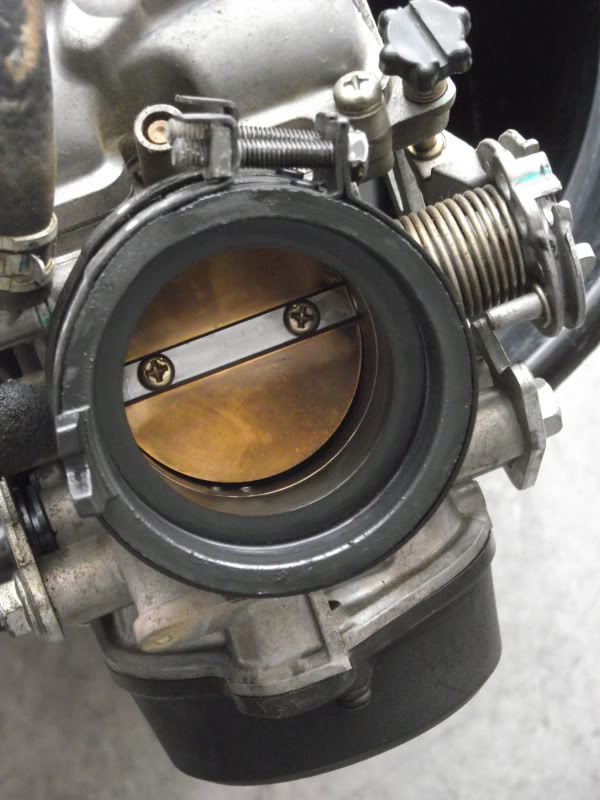

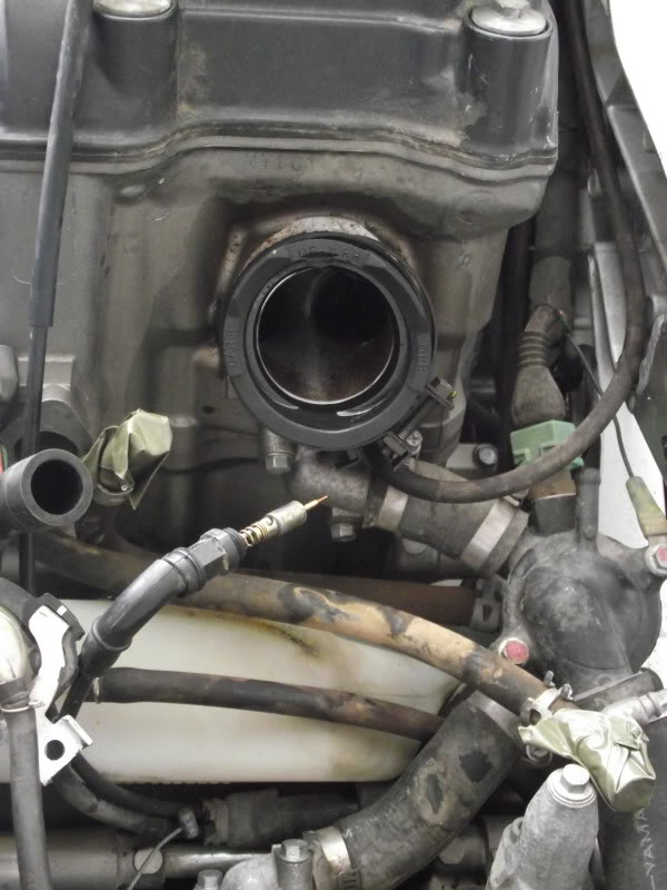

It's ridiculously dirty and we were right. There is rust in the carbs. I've got the first part of the gasket kit for the carbs, but I think I'll go ahead and take the time to get a new jet kit and rejet the carbs.
Old May 27, 2012 | 02:14 PM
GTS's Avatar
GTS
Seasoned tech
Joined: Apr 2012
Posts: 576
From: Issaquah, WA
A little wet sand paper in about the 1500 grit range on a sanding block, then a good buff will take care of the orange peel. Just be careful around the edges to not sand through.
Old May 27, 2012 | 02:59 PM
All you really need to buy is a set of pilot jets and then look at the carb set up thread I wrote that is in the Tech section.
You can save a little $$ and have a good running bike by just a few esy mods to the stock bits.
You might also look into setting the TPS while they are out.
