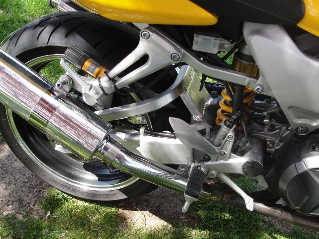

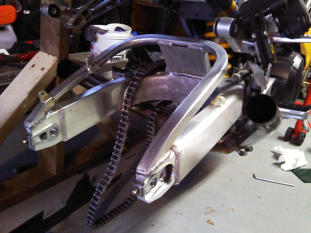

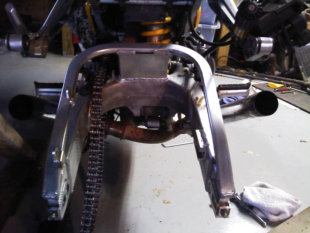

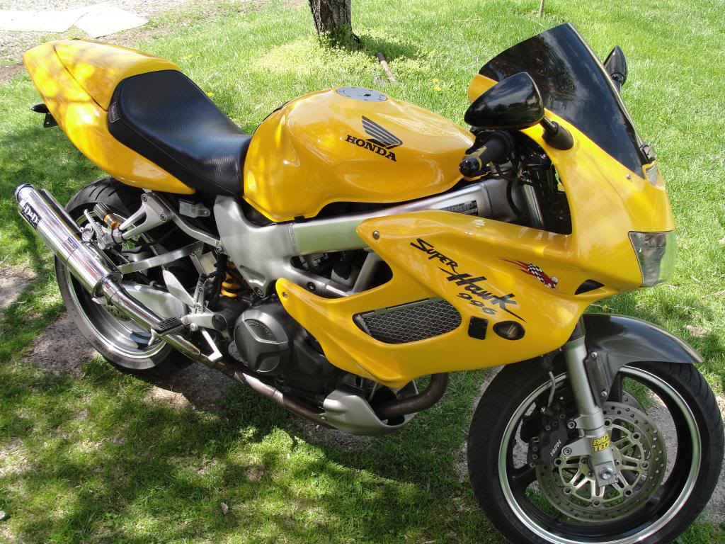

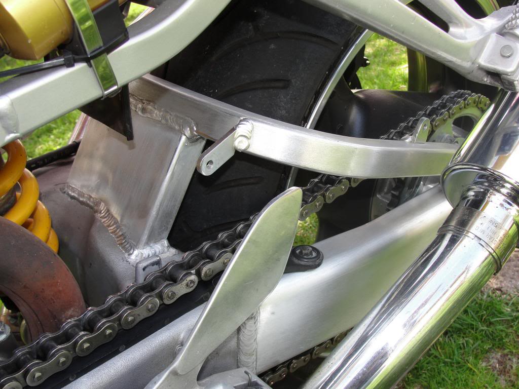

So I read this mod was one of the most involved and I now believe it. Lots of cutting, grinding, filing and fitting! Just got the bike off the stands today and went for a easy ride around the block.

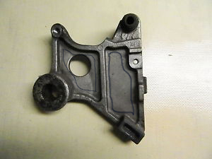

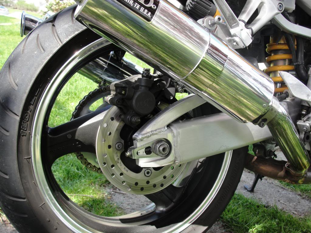

I powdered the caliper carrier flat black so it would disappear. Very happy with the results. I also cut out a bunch of material if you can tell.

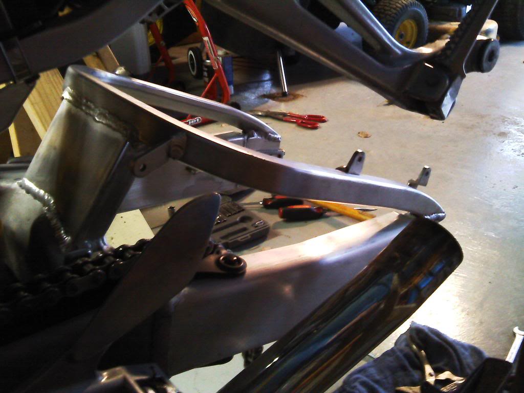

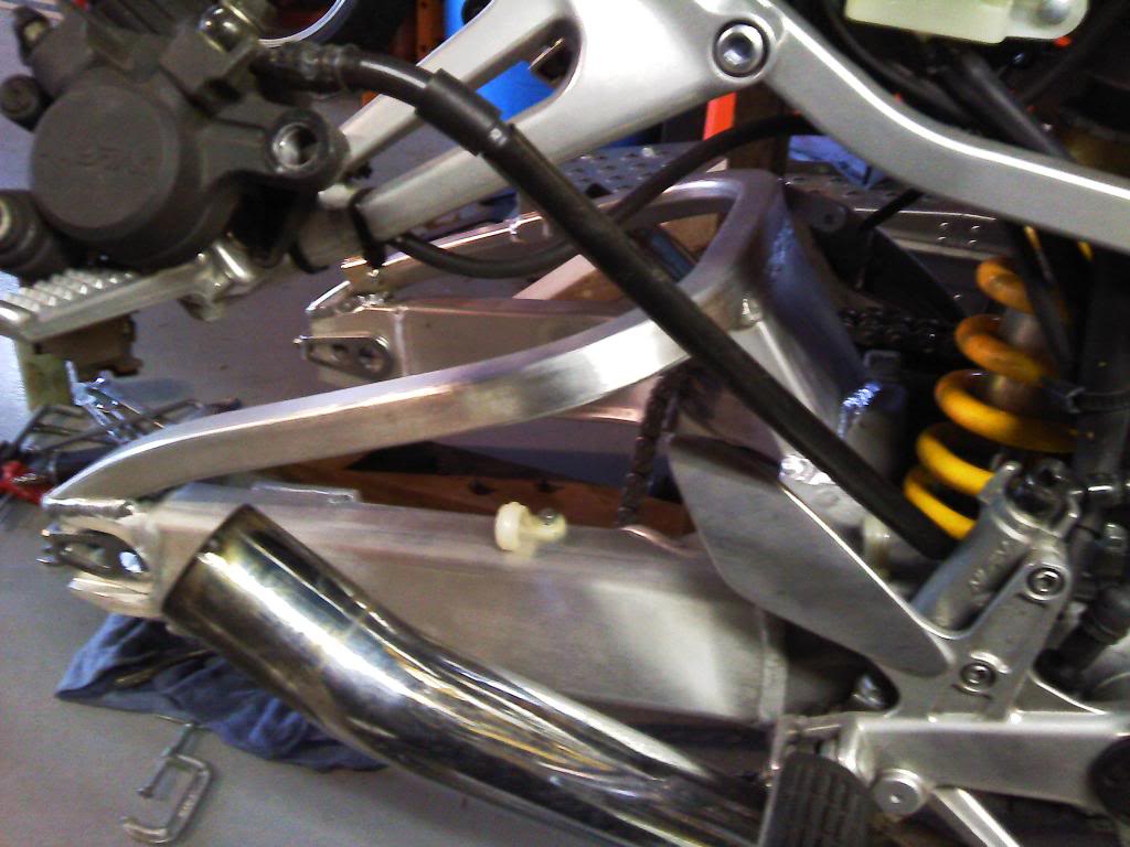

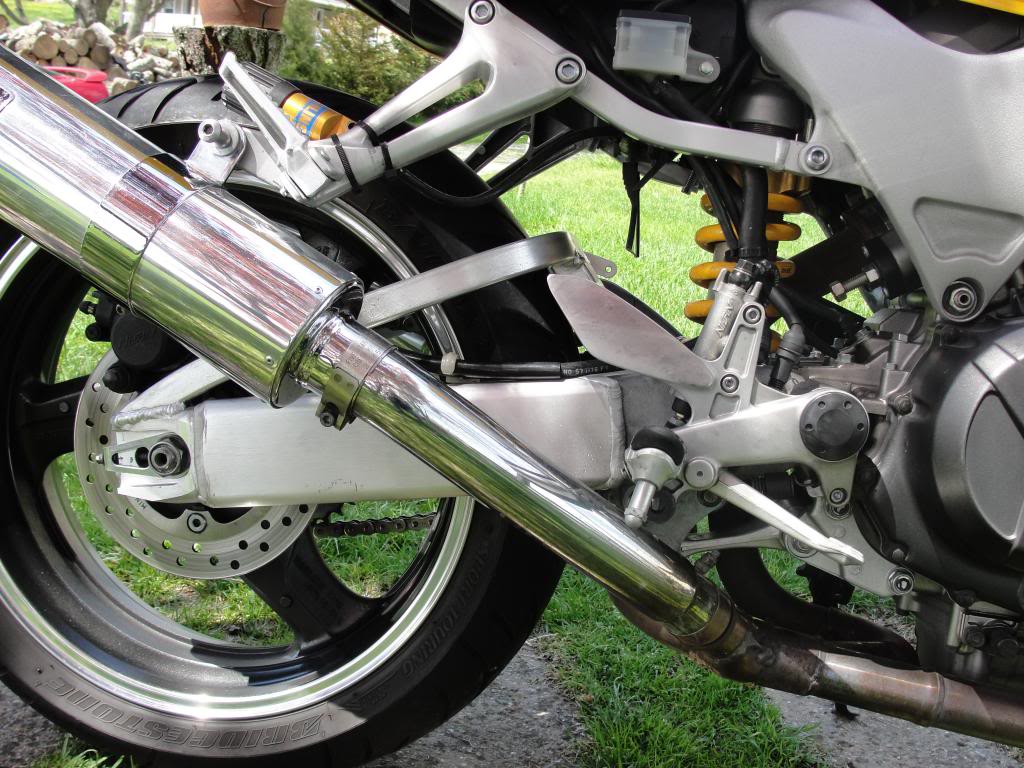

Some assembly shots. I know your admiring my custom "stands".

A new custom brake line is on my quick list. The OE one is not gonna cut it long term [for me]. And I'm not sure about a chain guard yet which is why I didn't cut off the brackets. I prefer something there to contain the lube. I do regular chain cleaning and lubing so the stuff does fly somewhat.

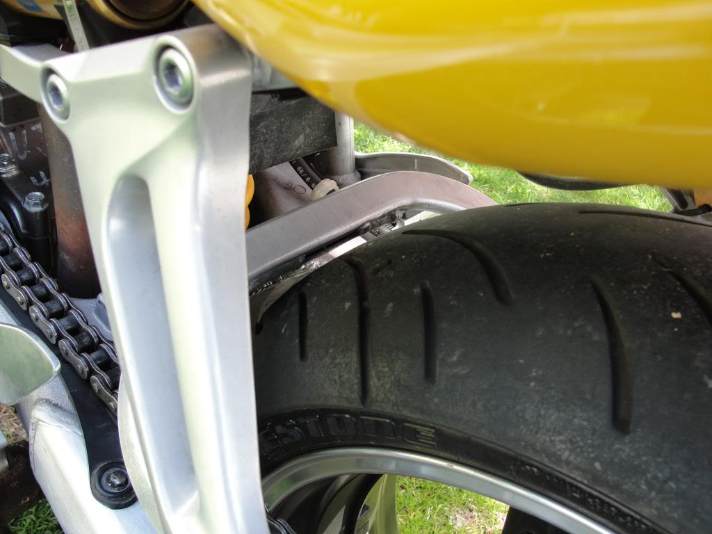

Overall really happy with the look and eventually I'll find out about the benefits. The tire clearance was a lot tighter than I hoped, but it is a new[er] chain.

Old May 4, 2014 | 06:52 PM
Looking good! Very clean
Old May 4, 2014 | 07:33 PM
Nice job!
Old May 4, 2014 | 07:58 PM

looks good. very worthy mod. one of the best ive done. a word of advice in regards to hugger/ chain gaurds... i used the same type of box brace you did which is the earlier 92-95 style. i bought a hugger/ chaingaurd from fleabay for aroun $75 for the later style 96-98 brace cuz i figure they were close enough of a fit. not the case. they have ones for the earlier style brace we used on there for twice the price. i ended up selling it because it would have been a weird fit plus it touched my cans. i settled on a hugger from Airtech for around $85 that doesnt have a chain gaurd. ill eventually try to find some sort of chain gaurd to go along with the hugger.
looks good tho and i know youll enjoy how planted the rear feels now. i was amazed at how much stiffer the rear felt when going over speed bumps. didnt even realize there was up and down flex when your vertical.

That is very factory looking, superb job and I even like the way the welds on the top plate by the brace does not continue right across and leaves a gap in the middle. Was there a reason for that?
Old May 5, 2014 | 09:04 AM
Posts: 2,098
Those are the factory welds on the 900rr brace, cybercarl.
Wolverine, do you have any pics showing your modified rear caliper carrier before or after mounting?
The end result looks great. Super clean Hawk,too.

Thanks for the comments. I was going for a factory look and I think I achieved it. Major props to the local welder I used, he did an awesome job! Miller Fab in Littlestown, PA. So all in @ $32.13 for the arm shipped + $50 welding and $20 for powder. $102.13
Yes, that's factory and no I do not. I was a little impatient to get it back together @ that point so I didn't take any pics. This shows the general idea of where I removed material.

Yeah, yeah, I've seen that picture. When will you be disassembling to get us some nice shots of the post-modified carrier?
