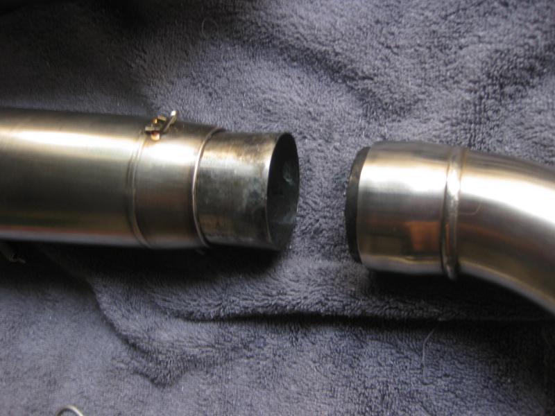

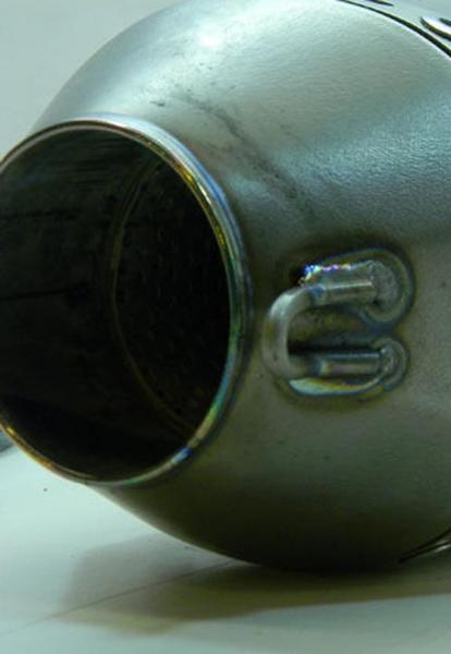

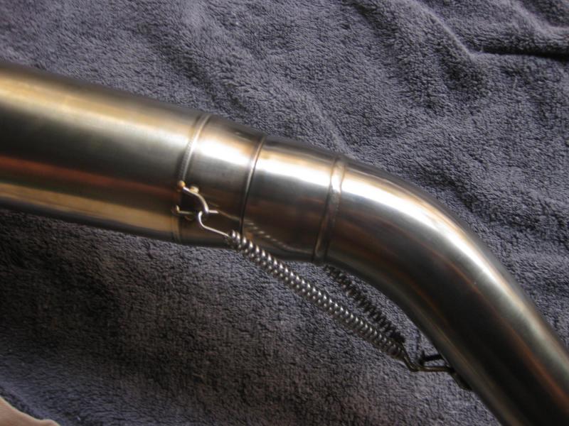

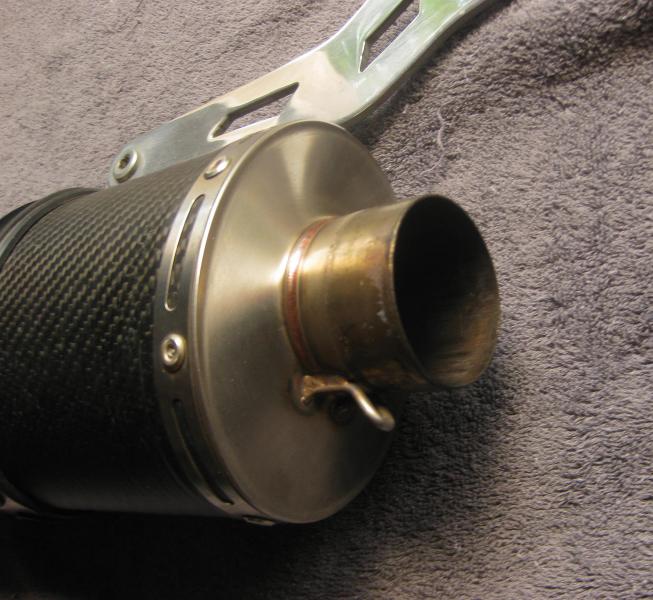

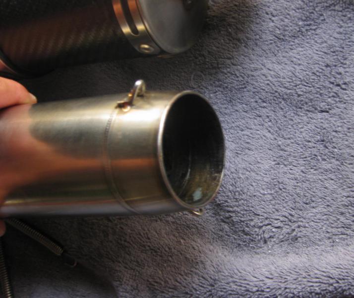

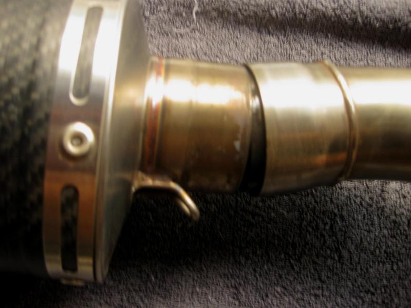

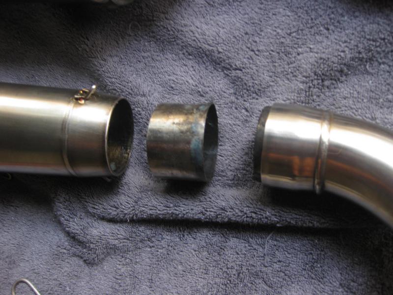

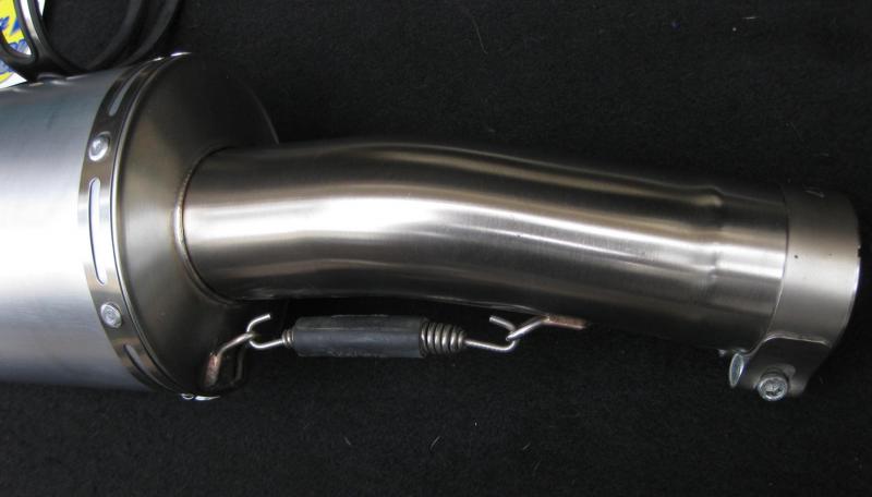

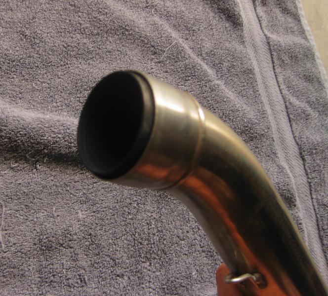

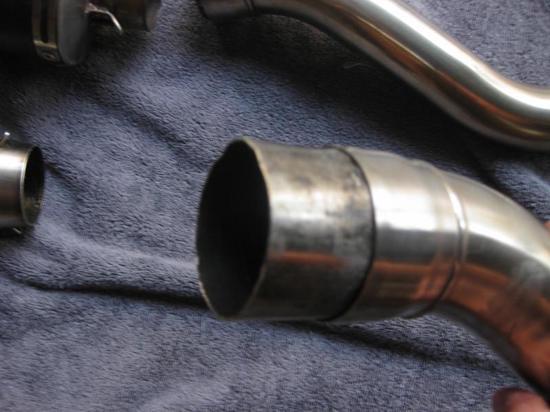

Anyhow I'll just post up here instead of emailing it. First pic is what the LeoVince high mount midpipe outlet looks like. It's a double walled outlet. The second pic is what the matching muffler looks like. It has a male inlet that fits in between the two "layers" of the midpipe outlet, shown in pic 3. Pic 4 (nevermind the shape of the muffler inlet I know it's conical not flat) shows the newer style female inlet that was on the last pair of low mount LeoVince mufflers I sold on here, similar to Hindles or Vance & Hines SS2Rs where the midpipe goes into the muffler. Pic 5 is the Danmoto conical muffler inlet, which is also the same.

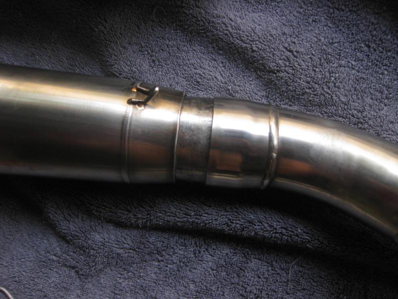

Pic 6 shows the small link pipe I made that I cut off an old pair of damaged Two Bros midpipes I had. It needed to be expanded only slightly and slipped into both the two layers of the midpipe (like the male end of the correct muffler is supposed to) and the female inlet on the Danmoto (or the newer style LeoVince muffler), shown in pics 7-10. I actually expanded my pipe by hand with a borrowed tailpipe expander. Really don't recommend this as it's a real PITA, the tool really isn't made to do this easily (broke 2 of the tools doing it by hand) and I only did it because I'm stubborn and the exhaust shop near me said they were too busy to help me that day. Otherwise last time I had them do something similar I just showed up and gave him a 10 and was good to go in 5 minutes with his hydraulic machine. Hope this is somewhat helpful.

Here's the pic of the female inlet muffler from LeoVince I was looking for that I wondering if you had.
