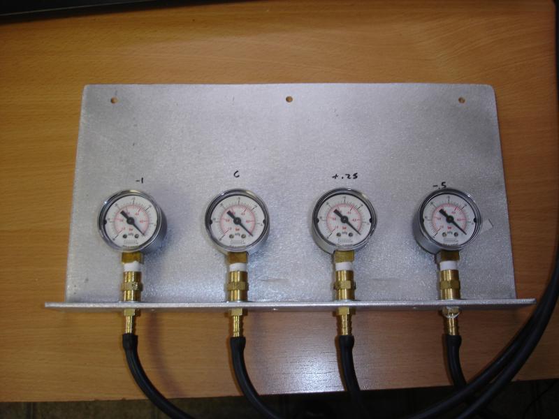

Alright so I have been working on my dad's cb750 1982. The issue I had was that the bike did not respond to the choke being pulled open, the plates where operating correctly. So I tore into the carbs replaced all the diaprahms made sure everything was clean reassembled the carbs put them on the bike now the bike starts when cold and responds to choke, but the idle sits at 3000 rpm and the idle **** is fully backed out. Anyone have any ideas about the problem now. I am thinking ballance issues but just wanted to pick the perpetual brain of the chicken clan to see or confirm. Thanks in advance.

so it was balance. I was able to test out my homemade sync tool and it worked awesome. Heres a picture of my setup. All in all it cost me $20 for all of the gauges shipped and $20 in brass fittings. Although if I did it again I could just get the female ended gauges then I wouldn't have had to buy brass couplers, that would shave ten off the cost.

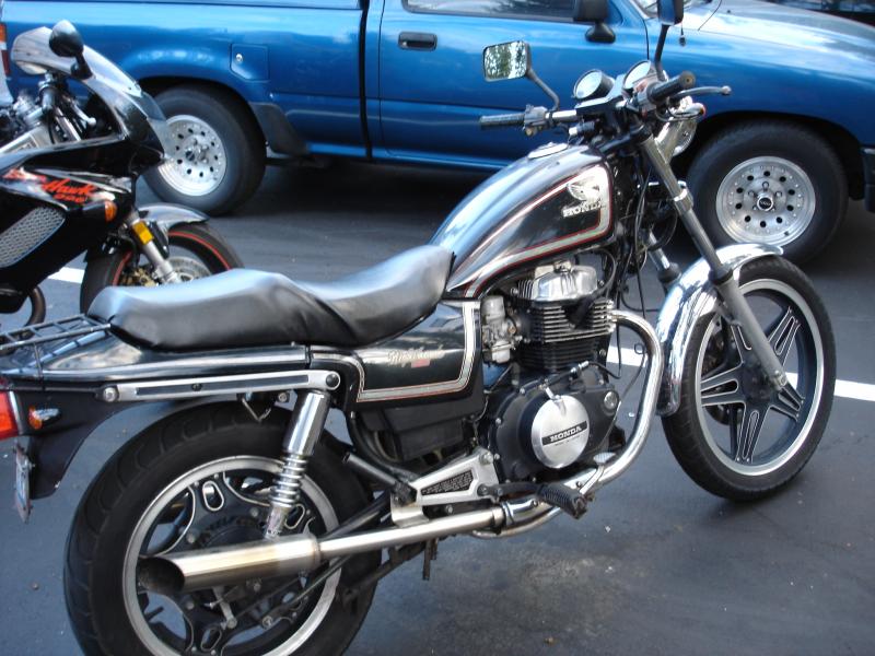

very cool, I like the old cb's too, my first bike was a cb 450 and it got me started well. Ones a 450 and the other is my dad's 750 c, the f was defintly sportier looking.
Attached Thumbnails Maybe someone here knows-motorcycles-027.jpg   Maybe someone here knows-august-vacation-015.jpg

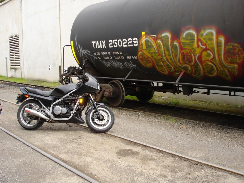

very cool bikes, heres another bike I brought back from the dead for my friend, a vf750f interceptor 1983 I think alot of people who own soup chickens started out on the older cb and honda's, and its cool seeing some nice examples still floating around in the hands of those who can still enjoy them.
Attached Thumbnails Maybe someone here knows-bjmotorcycle-001.jpg   Maybe someone here knows-bjmotorcycle-005.jpg
