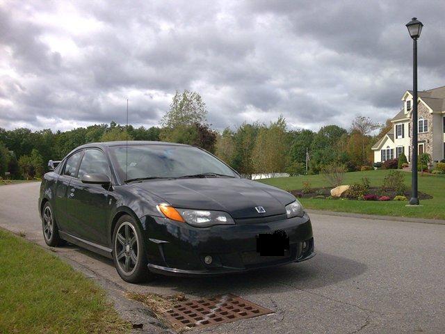

pic of said car, 2.0L I4

Please read post #3 carefully
Originally Posted by PUSHrod
You don't say how old the car is or the environment it has to live in
"The car's a 2004 so I didn't think grounds or connections would be corroded already seeming the car has been garaged since day 1."
Post #1 looks like the car lives in a nice residential environment
