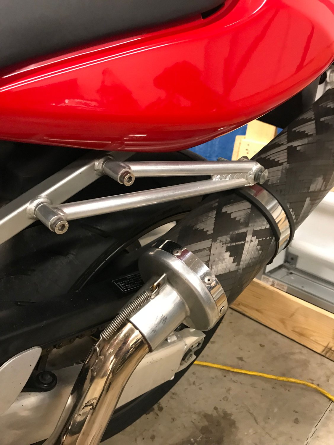

Had a guy call the shop I work at looking to add passenger pegs to his 2Bros high mount exhaust. If anyone has the spacers [and bolts], hit me up. TIA

We are talking about the two spacers that fit behind the peg mount, two per side
As is most machining work, its less the cutting and more about the set up.
I'm set up for flywheels right now, and need to due three of them before I change as that's a 2 hour set up..
For the spacers...as long as you dont want something fancy, just 6061 aluminum, basic profile and simple finish ......keeping in mind I dont have a CNC to pop out a dozen of these every 4 min.... its all hand set up, hand turned, measured and finished......
Need to know how long you want them.... It seems to not be a standard XX length, as it depends on if your looking to get the mount to clear the can or the connector pipe
