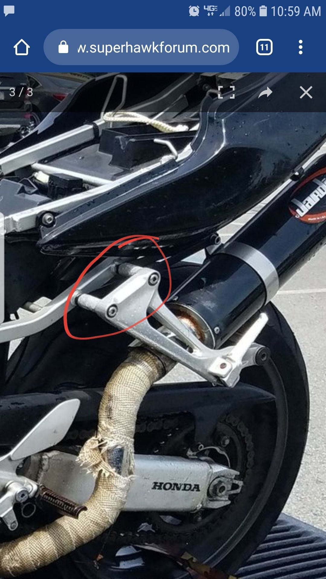

Looking for all the hardware to mount up a set of Jardine RT1 high mount pipes. If anyone has this stuff or knows where it can be found please help me out. Thank you

My bike came with Jardine high mounts, but someone lost/broke/bent the stock mounts, and were just replaced with two pieces of black painted steel strips that ran from the passenger peg mounts to the strap on the can. If you have issues getting the OEM parts, something like that might be a solution for you. Still need to find the strap for the can, but I would imagine you could find some from a similar sized can.

That is a great idea however I will need to find the spacers for the passenger foot rests

Thanks for all the help guys my buddy has a set of these on his Hawk so I have stuff I can reference to make a set for my bike.
