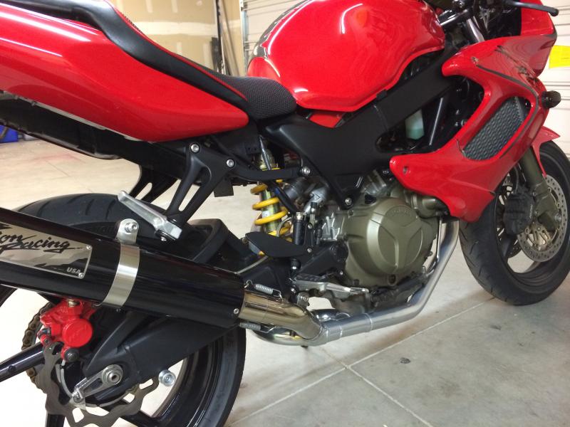

I've been able to gather enough parts to offer these again. They really are a great addition to our Superhawks. I've searched through many options for our bikes, including going so far as buying a CRF master cylinder and trying to retrofit it, but it will not fit our rear brake setup.
This kit is better than the HRC kit in my opinion. Here is why: The HRC kit uses the green tubing, which "breathes" and ends up getting soaked on the outside with brake fluid (check the CBR forums for the many stories). The CBR guys are upgrading to TYGON 2375 tubing, which is what I used. The HRC kit also uses ugly worm drive hose clamps. I used stainless Oetigger clamps, which are fuel injection rated, and look much cleaner. The plug I am using is a genuine HRC part, in the original HRC bag.
The last kits I had used a bigger ID tubing, which fit fine, but in my opinion these fit much better. I got smaller diameter tubing this time, and it is super tight when fitting it over the nipple on the master cylinder. The clamps aren't even really needed, but I use them "just in case".
The clamps are tightened using a poly crimper found at Home Depot (I use a German Knipex pair). They look super sano, like the factory would have done.
The kits will be shipped via USPS in a bubble mailer. I can assure you will be satisifed with them, as I am. These are the exact same kits I have on my bike now. If I didn't like it, I would remove it.
This allows you to remove the stock bulky reservoir mounted on the side of battery box, along with the big reservoir hose.
Don't worry about there being less fluid in the reservoir. When you press the back brake pedal the fluid barely moves, as the rear brake's piston is pretty small.
I have ten of these available, and will do my best to ship pretty quick. I'm doing this because of my love for the Superhawk, and my neverending quest to make them better both functionally, and cosmetically.
Edit: The setup is super flexible, so if you hit it with your boot it will not hurt it.
Edit 2: Last time these were $12 shipped, the material cost went up a bit this time, so these are now $15 shipped. Sorry about that.
Preferred payment method is paypal. You can send payment, with a good shipping address to: thedeatons at g m a i l . c o m.
James

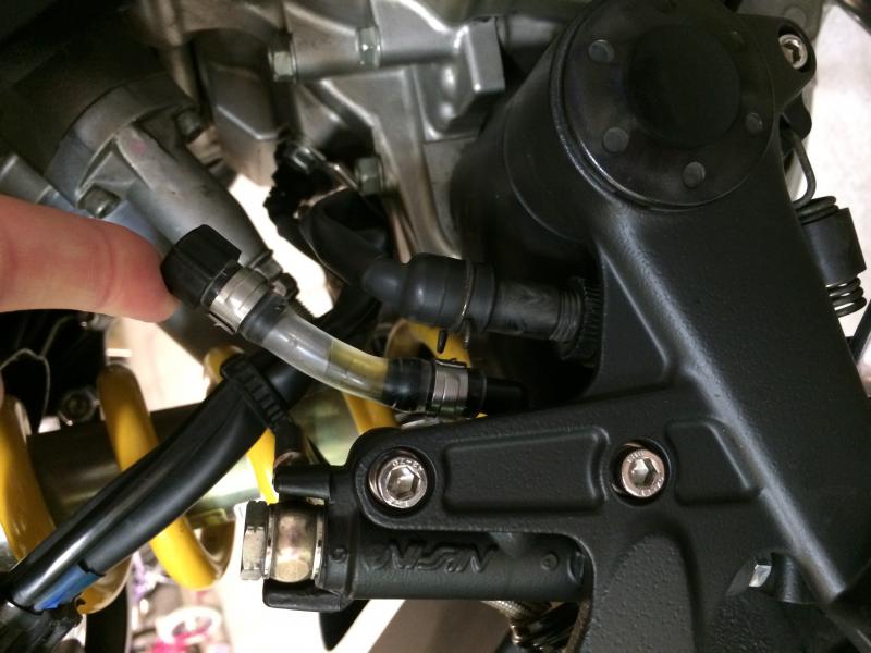

Pic 2

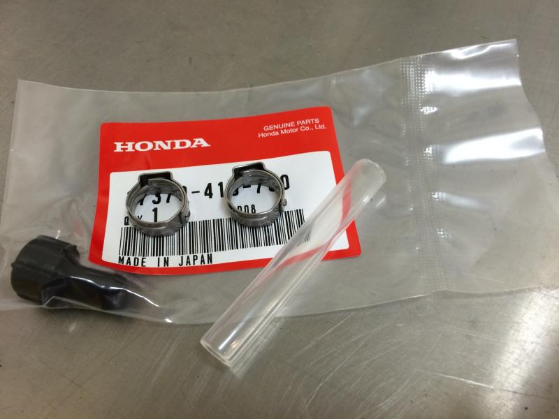

Pic 3

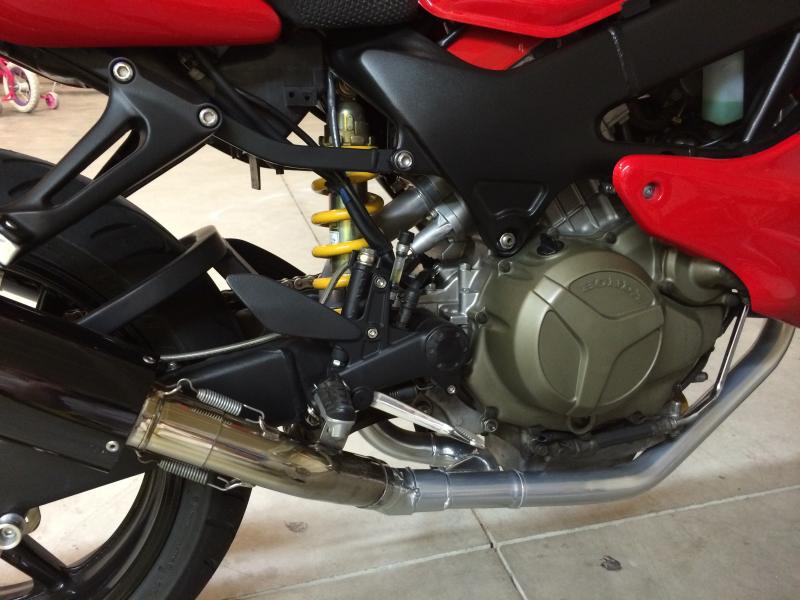

Pic 4

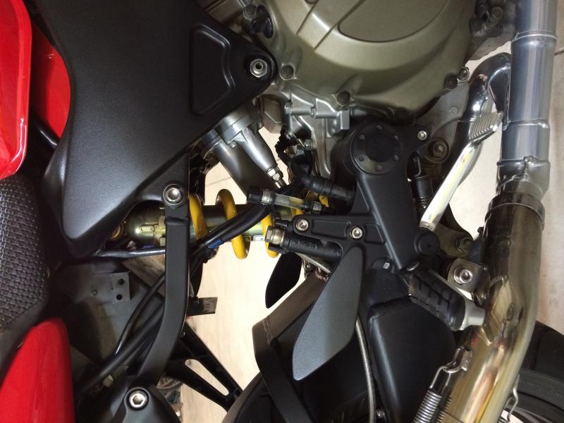

Pic 5

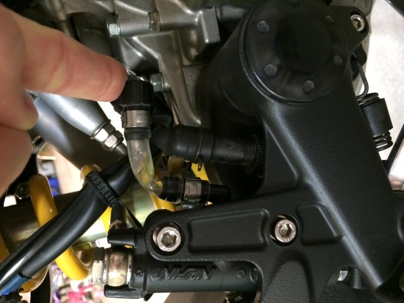

Pic 6

Pic of parts that will be shipped
