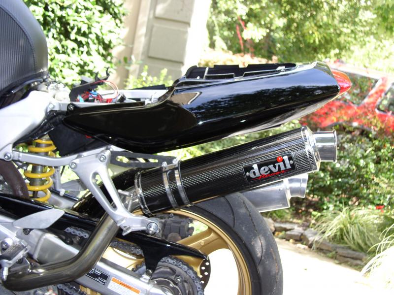

it looks like he has an integrated tail light. at which point he bought that is the question. as for creating an undertail exhaust...
you will need as much room as possible----you won't be able to use the mototek or any fender eliminator. In fact, max dia on the exhaust will be roughly 3", and depending on the height that you mount the exhaust at, you will either be dealing with a bun warmer or a tire rub (over sizable bumps). Well, actually, you will have a bun warmer no matter what. I have a 600rr exhaust that I thought about using but it wouldn't fit, too tall.
the easiest, and the guys who have had the most success (and something, if I WAS going to do it again, I would do) have been using the R1 exhaust and rear tail. Key items that it has making it more successful:
-a tail, electronic mounting, battery mount, and exhaust mount that are not prototypes
-Available stock and aftermarket exhaust (trust me on this being somehow cheaper then your time and materials)
-If done correctly, tire clearance
Now, I know that opinions are like ********, everyone has them and they all stink, but I hope that your exhaust goes better than mine. Keep in mind that I have an entire fab shop, casting facilities, and a machine shop at my disposal. If I was to do it again, I would purchase a full system exhaust and keep some free time, but I can understand the desire to create a one of a kind motorcycle.

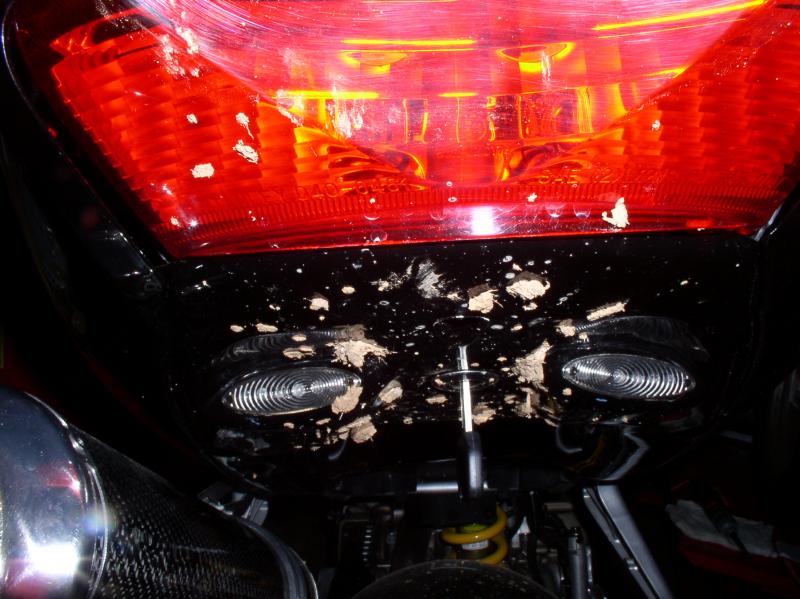

Mine is identical to Billzilla only in yellow. I found that the turn signals with the undertail are nearly impossible to see from the back as the LED focus is quite narrow and they are pointed a bit to the sides. I added an integral tail light also, but not the clear Alternatives; one of the knock offs. Perhaps not as bright - don't know, never compared side to side, but they are visible from the back and it gets the job done
I read that on here also about the undertail turn signals not being big enough. Thank you, ill keep that in mind! What was the price difference for your taillight if you dont mind me asking?

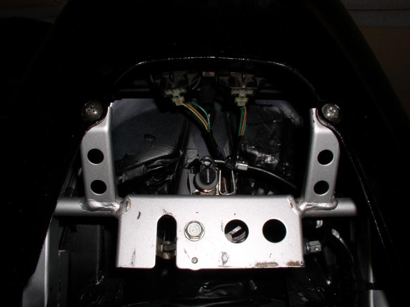

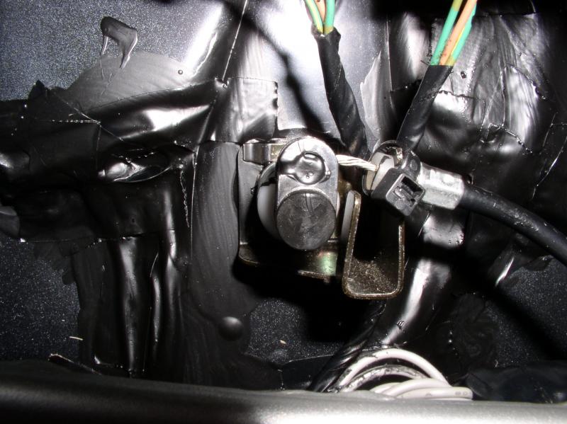

What did you do with your seat key lock when you removed the stock fender?
here's what i did, this is all before the mototech undertail
i took everything off
trimmed it to very minimum
Filled in All the holes including the lock cylinder
Painted The Whole Thing Flat Black
Then I Driled a Hole On The Under side for the Lock
This allows you to put the plate directly under the taillight instead of hanging down under the reflector and for plate lights i used the led bolt light from herehttp://www.customdynamics.com/illumi...#LED_Tag_Bolts
and youre all done hope this helped

I made my own integrated tail. The mototek blinkers are very hard to see, especially on a yellow tail.

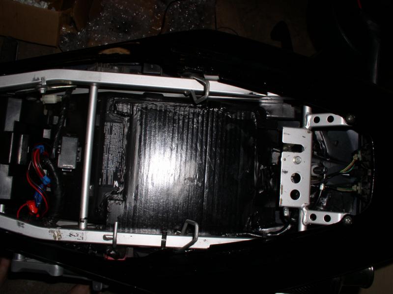

The Mototech undertail requires that you cut the tool storage tray out. The seat release key relocates and the LED turn signals wire right up. They have an optional; running light connection (grey wires) but they are not very bright and I think they detract from the turn signal visibility.
I glued a piece of plastic over the section I removed from the undertray so I could keep documents and such under the seat without them falling down into the undertail.
