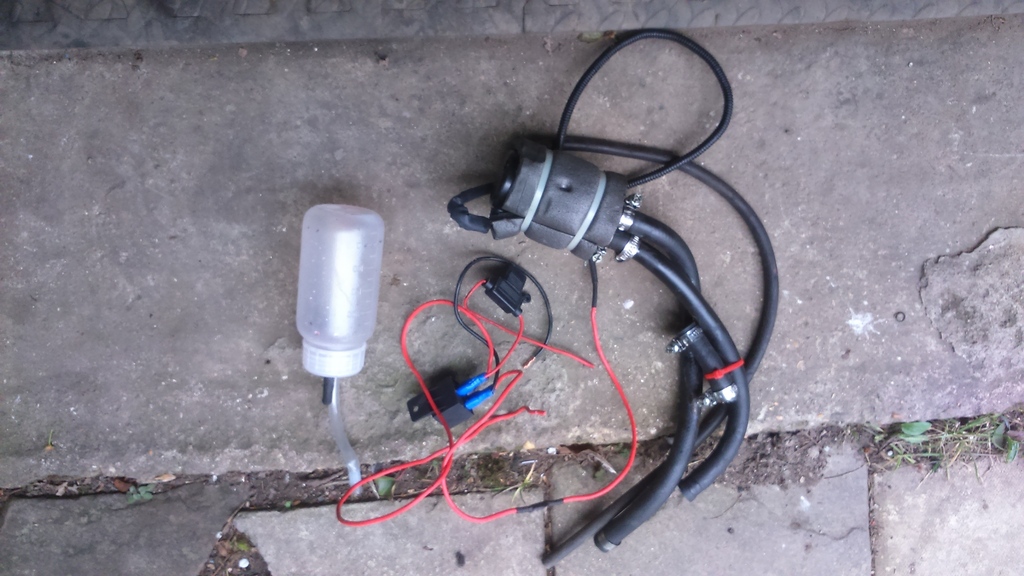

2. Fuel pump conversion- a recommended mod for a track day bike.
When I had mine fitted it sat neatly in the vee between the cylinders, meaning that you remove the coolant catch tank and fit a nice neat HRC overflow bottle instead- so I'll throw one of those in.
I used two dry-break lines with 8mm fittings on the two fuel lines from the tank, so it makes the tank easy and quick to remove. The flow rate is way higher than you will ever use even on track with a wot, so no worries there. You tee the two lines together and feed into the pump., then the pump outlet tees into the two carbs.
There is one other mod to do with this mod- as I found out when trying to keep my bike running on the way to Devon last year
but I sussed it in the end. The fuel tap diaphragm is "sucked" into the closed position by the pump's "vacuum" which stops fuel flowing. To stop this happening, all I did was to disassemble the fuel tap and place the small spring on the other side of the diaphragm- simples. That's on the early fuel tap type, the later one is ok, just remove the fuel tap and connect up the dry breaks instead. And that will save some weight!
Including overflow bottle, relay, fuse and wiring, ready to go, £45 plus postage.

By the way I've replaced the stainless but longer exhaust studs on the front head with new Honda ones- I fitted the longer ones for my headers with Lambda sensors in for the realtime a/f display I was running.
It stops fuel surging on heavy braking or acceleration, also gives more consistent fuelling. I found that it made the bike run richer by approx one main jet size., i.e. I could drop one main jet size and get to the same af ratios.
When fitted, you get consistent fuel pressure whether the tank is full or empty.
You don't get more power, you get less variability.
Yes, and it comes complete with everything you'll need, including an HRC coolant overflow tank. The pump sits in the vee where the std coolant overflow tank goes, so an HRC one does the job and sits just above the RH side radiator.
I'll throw in the fuel line quick connects as well.
