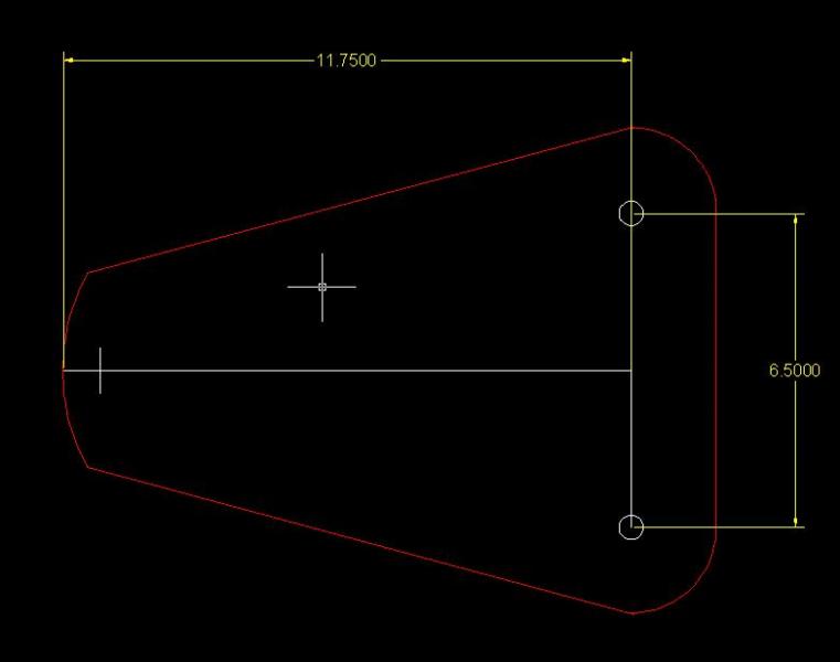

so then what is the distance from hole to hole, on my rack they are shown in the drawing, I could make something different but would need these to measurements in order to make it. red is the overal profile of the back seat

Hole to hole is 8 1/8". Front to back is approximately 10 3/4". I will get an actual front to back measurement tomorrow morning, but this will give you a good idea.

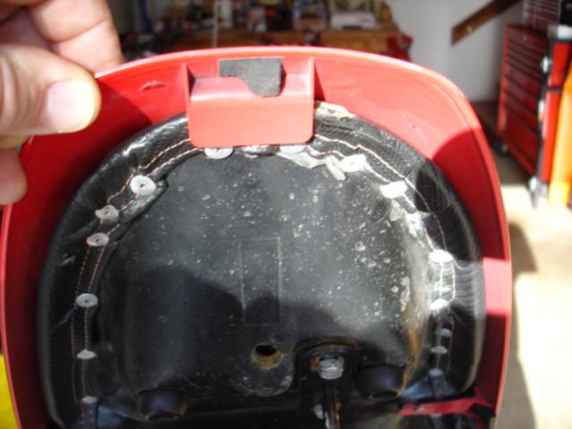

Do you need some pictures of the seat/cowl and measurements?

a few pictures of the seat with the cowl, and then a few with it on the bike so I can see how much gap there is between the cowl and tail bodywork, I need at least and 1/8 in if not more, for me to even be able to think its possible. I may throw it down on Solid works so I can see if I can model it in 3d.

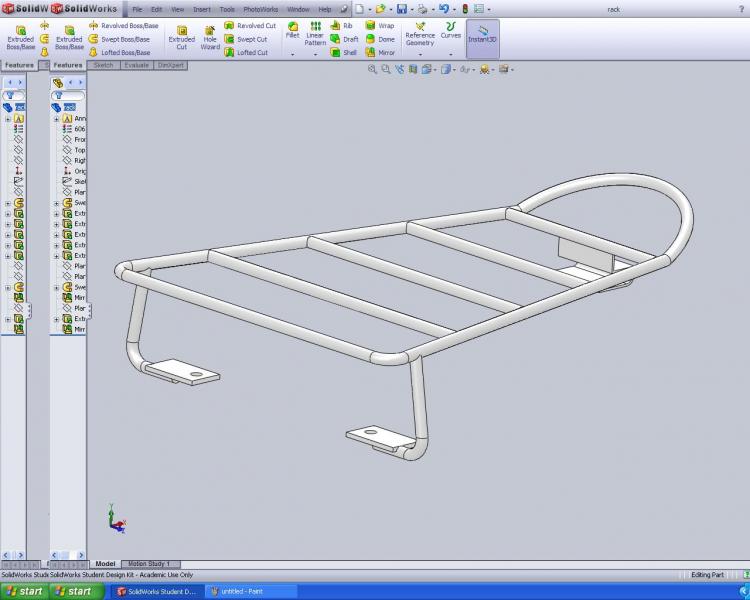

heres a shot of the original, I will bring my cowl in tomorrow and create that in 3d than I will make a "dummy seat" put everything together and figure out if it can be done.

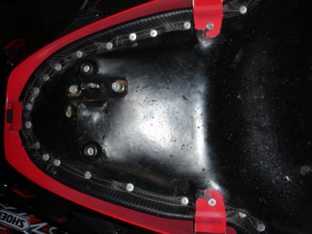

Corn:
Here are a couple of pictures of the cowl and rear portion of the Corbin seat.

Originally Posted by reaper
Corn:
I have tried to figure out a good way to make it work but in the end I don't think its time effective or nearly as strong/ useful if I have to avoid the cowl. I am sorry Reaper

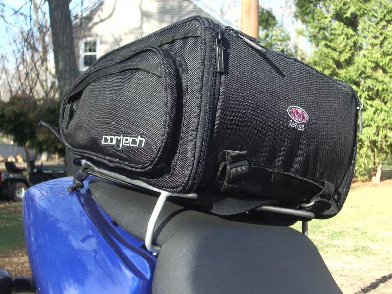

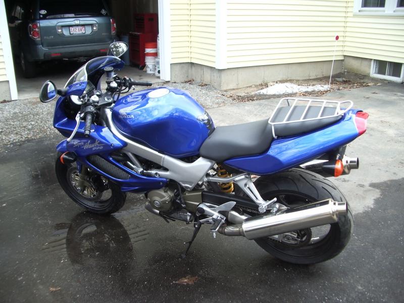

Anyways BlueStreak sent me a couple of great photos of the rack I sold him I thought I would post up for you all.

Hi Andrew;
My rack's been excellent, pretty much always under my tailbag. If I were to go to a Sargent Seat in the fall, can you help me modify the rack to fit?

Unhappy Rack for sale
Just replaced my stock seat with a Sargent. New seat is great, but sadly, Andrew's beautiful little aluminum tail rack won't fit it and is not easily alterable to fit. I've gotta sell it. It's only 4 months old and in prime condition. Is excellent at protecting the paint on your seat cowl. Send me an e-mail if you're interested.
