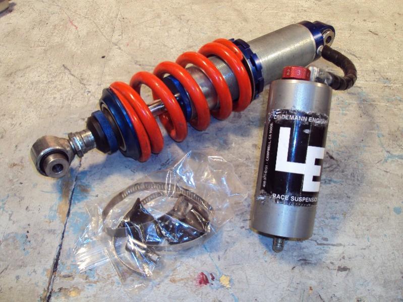

Fox Twin Clicker Shock, fully adjustable W/ 600X900 Spring;
Recently rebuilt by Lindemann Engineering and set to 300psi
(less than 1k miles of riding on rebuild).
Purchased from Indierocker about a year ago, but never got it installed before I sold my Superhawk
I was told by Indie that this was last used on a SuperHawk by a ~260# rider about a year ago. Spring may not be ideal for that weight, but I was told it worked just fine for the rider.
This should be a bolt up, set sag, and go riding deal for someone.
$400 + Shipping
P.S. I don't have the hose clamps in the picture.
Attached Thumbnails FS: Fox Shock for SuperHawk-fox-shock.jpg
