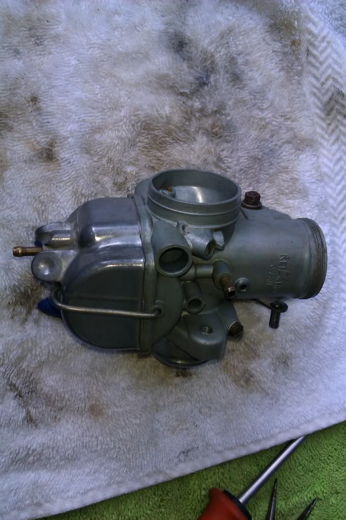

Here is a pic of the carb in question.
And like I said , I just need an old body , everything else is good.

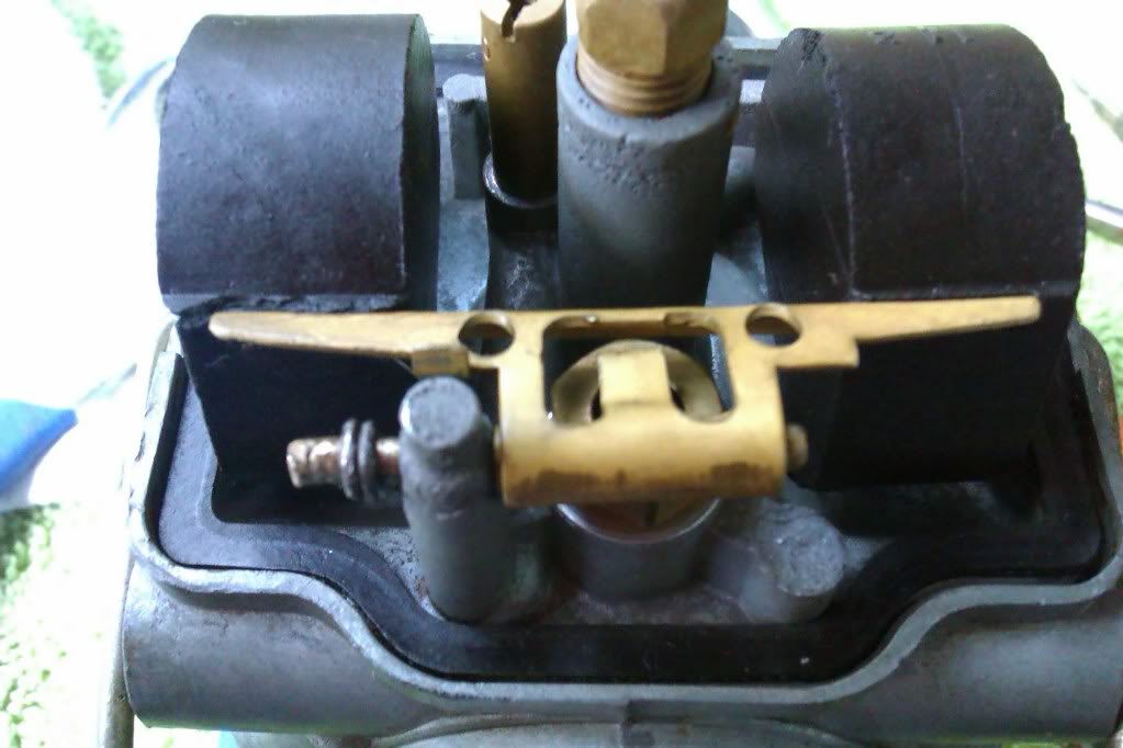

heres a pic of the broken stem ... as you can see , I have rigged it so the bowl doesn't overflow ... but it's shady as hell !
Pot metal doesn't weld very well !
DENO
Pot metal doesn't weld, period!
PM me and we can work something out; that post is 100% repairable!
And that looks to be the #4 body (furthest right when sitting on the bike), is that correct?
I'll rummage around to see if I have a spare body, but rest assured, it is repairable.

The post is broken on the number 3 carb , left to right. I have heard that JB weld works just fine , but havent tried it .
What do you suggest ?
Thanks rr-rider !
DENO
I don't really like JB weld because I've seen it fall apart while on a ride before. Ask me how fun it was to jerry-rig a cb360 in the mountains -_-
I've always created a new float post by drilling/tapping the body and threading a rod to go into it. Then I just cut to length, use a dremel to make a small flat where the hole in the post goes, and then drill. Takes about 20 minutes and I have never had one fail yet.
If you choose to go this route, you just need to do a little research on the best sizes and make sure to get a bottoming tap and matching dye. I use off the shelf aluminium rod to fix it and I usually add a dab of epoxy to the threads once I've verified that it functions perfectly.
Much more permanent and IMHO a much better, cleaner fix.
Thereagain, this also requires that you aren't afraid of drilling into your carburetors
