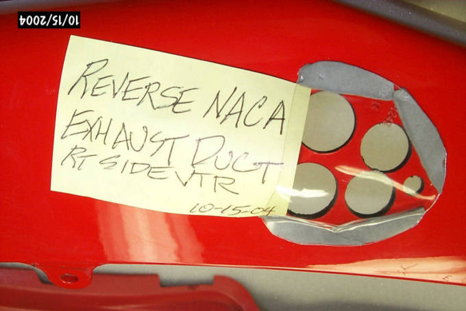

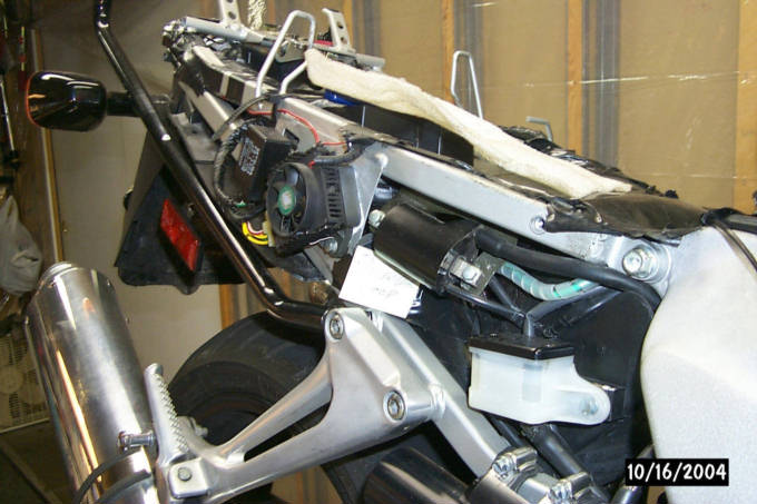

Old May 31, 2008 | 07:04 AM
Posts: 2,222
Originally Posted by KindredGhost
my new mechanic, and he said the best thing to do would be to get a finned unit, and throw a cpu cooling fan on it. I think I got a good deal.KG
U did get a good deal. See pics below of what I did on my 98, which has had no problems (knock on plastic)...
