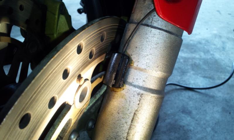

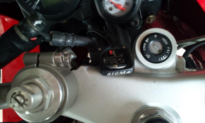

i took it off , but just wondering what it was?

That's the mount and sensor for a bike computer...

what does it keep track of
Old Mar 3, 2012 | 03:13 PM
It is a replacement for the speedo...

cool thanks for the info.... u think the orginal owner disconnected the orginal speedo so the bike won't register any miles?
Old Mar 4, 2012 | 06:38 PM
If the pink/green wire is disconnected the bike will run normally but not indicate any speed/mileage. Check that wire to see if it's been modified/cut/spliced and that should answer your question.
A lot of guys installed the bike computers because you can indicate a more accurate speed based off the tire circumference. The stock speedo reads about 7% high. I would read higher or lower if the PO modified the gearing.
