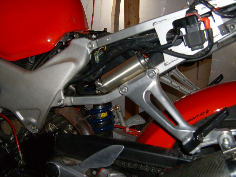

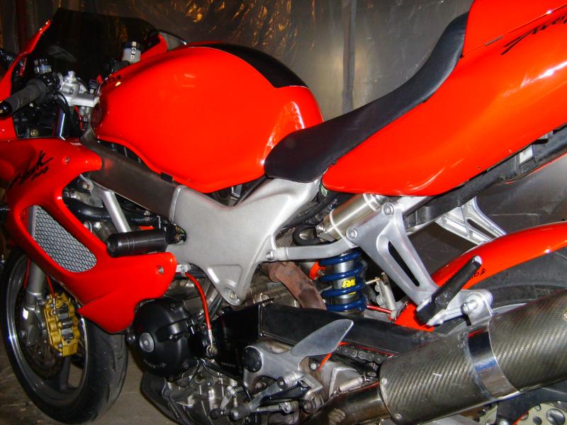

Originally Posted by NAVY8TR
got all the components to do the f4 shock mod, bought the shock used off ebay had it shipped directly to jamie, he did the racetec gold valves and springs and made a bracket to fit the f4 shock into the vtr. here are some pics of my progress today, had to call it quits to go do homework...
FYI - The third picture in this post shows the CBR linkage parts which are not used. The converted shock is a direct replacement for the original VTR unit. Just a clarification!

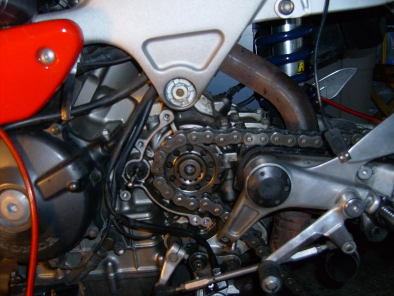

Old Oct 20, 2009 | 04:15 PM
  #37
NAVY8TR's Avatar
Joined: Dec 2008
Posts: 226
From: Corpus Christi, TX
finished with the shock today. took my time with all of it, did some cleaning while i had the whole tail section off. man it was pretty nasty. rode around a little too since we had a 55 degree afternoon. took it fairly easy. things i noticed in the 40 miles i did: bike is higher off the ground - concerning with the kickstand down, needs to be parked on flat or with kickstand uphill. it is also tough with a 31 inch inseam, but not bad since i'm used to it already. bike lays over easier, doesn't have a huge "pop" kicking my *** off the seat when going from side to side. absorbs bumps like whoa... Keep in mind this was a short test ride in maine, cold temps, bad traction, frost heaves ect...
Installation is simple, if you know what youre doing and have trashed all the extra F4 parts. out of sight out of mind. bonus is you don't spend any time trying to fit F4 parts where they shouldn't be like I did. Resevior placement is all up to you, what i did was put it off to the side sitting ontop of the rear subframe's bottom bar, clutch side. with this placement it was necessary to dremel a cut-out to mate the tail section back on. I like it. it looks sleek. check out the pictures. oh theres one pic in there of the 15 tooth renthal that i put on when i had everything apart, its pretty sweet, comes up nice and easy in second now. no f-ing around anymore trying to get it up (...thats what she said!)
Attached Thumbnails VTR replacement Shock-hpim5867.jpg   VTR replacement Shock-hpim5866.jpg   VTR replacement Shock-hpim5865.jpg   VTR replacement Shock-hpim5858.jpg
