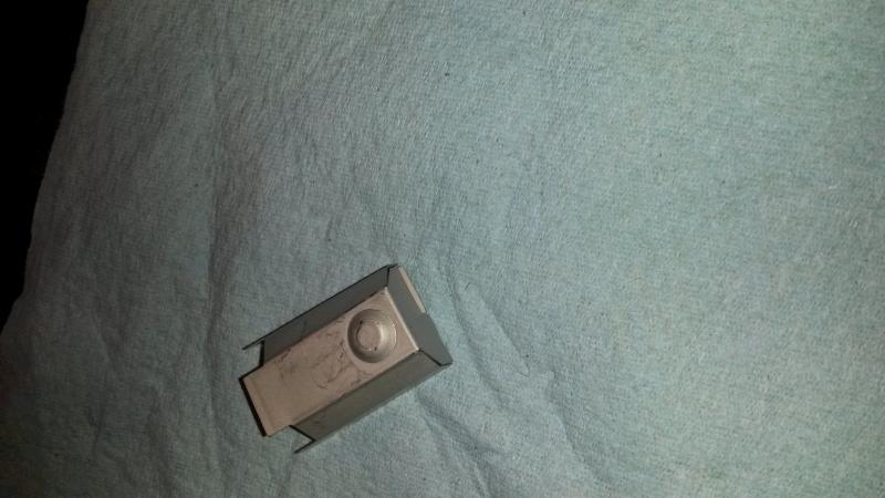

One other question. May belong in a new post.......but when I took off the tank it sounded like I had a bunch of loose nuts and bolts inside. Tilt the tank side to side or front to back sounds like something is loose inside. I have a 2001....wondering if this is normal (fuel gauge innards or tip over sensor) or if the PO actually dropped something in the tank? Will have to drain the tank and see I whats going on in their.

No not normal

There may be a datatag/microchip anti theft type device rattling around in there. You know the type of security device that helps track down stolen parts. The only way your going to know is to drain the tank and fish it out.

Found this rattling around in the tank (see pic). Fished it out with a magnetic pick up tool.
I think its a piece of the fuel sender unit. Fuel gauge seems to be working (2001 model). But I'm guessing I need it or Honda wouldn't have put it their. Will have to take the sender unit out and see if I can re attach.
