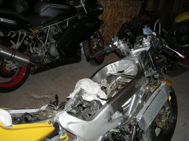

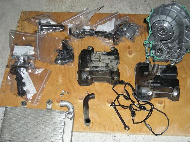

Now that riding season is over, I've been taking apart my '98 VTR in order to check the valve clearances. I just determined both exhaust valves in the front cylinder are a bit too tight (0.009"). In the rear cylinder, one intake valve is a bit too tight (0.004") and one exhaust valve is a bit too tight (0.009").
Next step is to get the proper size shims.
(although the bike ran fine and is still capable of doing a buck-sixty )
An opportune time to change out the coolant pump seal as preventative maintenance. The original one failed at 22,000 miles and the bike now has nearly 57,000 miles (although there is no leakage from the inspection hole).

The other preventative maintenance item to focus on is the possible problem with the cam chain tension I've been hearing about.
I've never had a problem with the cam chains. Is it the cam chain tensioner lifter, the cam chain tensioner or the cam chain guide that is prone to failure??
