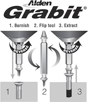

Part of my daily at work is extracting broken fasteners in aluminum.
I can't recal what the coolant drain bolt looks like, but i bet a Grabit style extractor would work on it.
Use a power drill for step 1, but use a 1/4" drive hex screwdriver for step 3.
You can also use a regular drill bit for step 1 that is slightly undersized from the grabit drill end diameter.

Looks like I need to get a head gasket and pull that front head to get to the leftover bolt. I already knew this was the correct answer, would rather it was something else though.
I'll look into getting one of those Grabit extractors.

Well, I got the head off, got the grabbit extractor in there. The bolt is seized pretty good in there because it snapped off the extractor.
I wish I had just drilled it out.
Edit: All good, I ground the extractor piece out with my Dremmel, then drilled and tapped it for an M8 bolt. Should be good to go.
