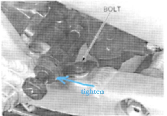

Right from Day 1, my choke would not stay out.
I have to keep a hand on it, to keep it out.
fuzzuki, you probably need to tighten the little rubber grommet kind of piece where the choke is. See attachment.
When I bought my bike mine did the same thing and would not hold its position on its own. I thought it was wierd so I did some searching and found a similar person complaining about it on another thread. Saw someone post the pic I attached and it fixed the choke from sliding back in. All I did was tighten it with my hand as snug as I could. Works great now!

Wow, do I feel stupid?
Tightened it up, works like a charm. I didn't even have to take the alarm off of it to do this. And it has a motion sensor.
3 years I lived with it like that.
Thank you haknslash.
