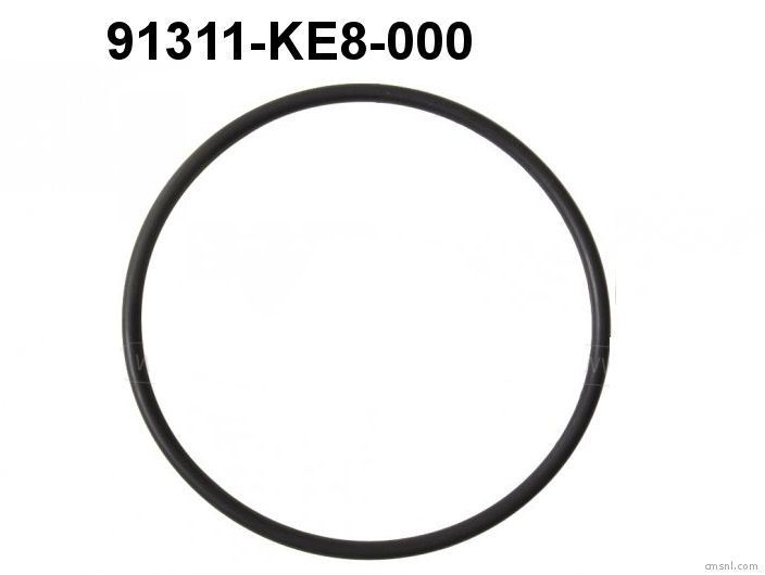

Its just a simple thermostat housing. You can order the gasket or cut one out of gasket material
Ahh, the VTR housing uses a 47.5X2 O-RING to seal the housing.... not going to be cutting that from gasket material
lol the king of part #'s and another item to add to the list haha
