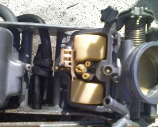

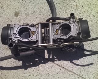

ok....that took about 30-45 mins to get the carbs off. Whats next? where is the pilot jet?
And when i get it all bsck together where do i hook in the sync gauges? ive always hooked them to the intake boots on other bikes

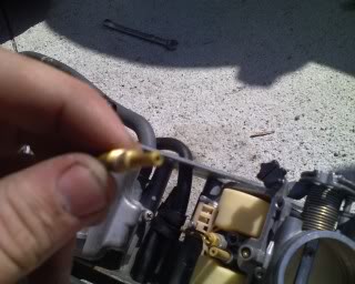

I dont know what each jet is called... but I left the main one in and pulled the other one out....the 1st one looks pretty clean as well as the inside of the carb... However the jet in my hand was stopped up but i unclogged to with a piece of wire.
I also noticed something the front carb has a 175 and the rear has a 180 main jet in it ...... is this normal?

it is normal. If you don't have a shop manual, you can download one off this forum. You need to order a fitting that goes into the bottom of the front carb(remove allen bolt). And set up the quick sync that allows you to merely lift your tank, hook your sync tool up, and start you engine. We can explain all this in detail but it has already been done if you search a little.
You may as well shim needles and adjust the air mixture to 2.25 turns out, set the TPS, remove the PAIR, etc.

Well two things to add here. First, cleaning the pilot jet with a piece of wire is not really a good idea. It is very easy to oversize the hole in the brass jet while you are trying to clean it. The best bet is to just spend the $5 and buy a new one if you can't get it clean with just cleaner and compressed air.
Second, stock jetting is 175 front\178 rear but you are close enough
Then again they might have changed that in later years.
I used the wire out of a bread tie.... it slides though the same jet from the other carb
mine is a 1998....Is 175/178 stock jetting no matter what your elevation is? I also have aftermarket exhaust and airfilter. So should I try rejetting?
Well it's one of those things that might work or might cause damage. If it runs fine, then no worries. I just replace them myself so I don't have to worry about it.
The high altitude (above 6,500 ft) jetting was 172 front\175 rear otherwise it should be 175\178 stock in '98

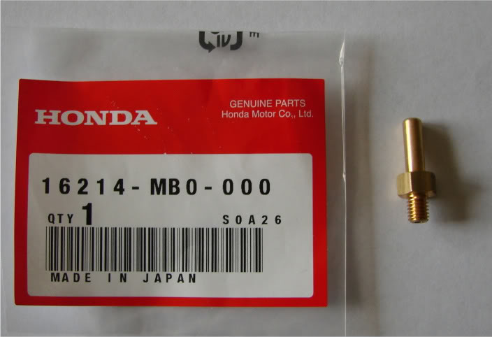

+1 ^ Soak jets in Seafom for a few hours - that will get them real clean, then use carb cleaner, then air - no wire. Note, the front and rear needles are different, do not mix them up.
The brass fittingName:  JointBoost.jpg
I urge you to adjust the TPS whie you are in there. Look in KB for sticky.
