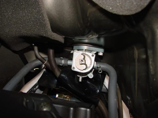

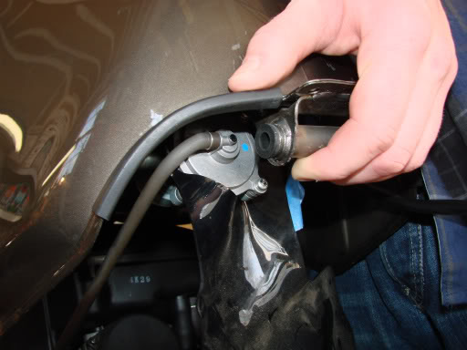

Just to make sure, your lines hooked up like this?
Front
Rear
The two fuel lines and the skinny petcock line are the important ones.
(images jacked from another thread)

The line in the second picture Moore posted is the one you should be sucking on (not the line itself, but the nipple it attaches to. The 2 big lines in the first picture are where the fuel comes out (again not the lines, but the nipples they attach to)
The line that hooks up to the back of the petcock runs along the left side of the frame, make sure that is the one hooked up to that part. See if turning the petcock valve to off changes anything.
