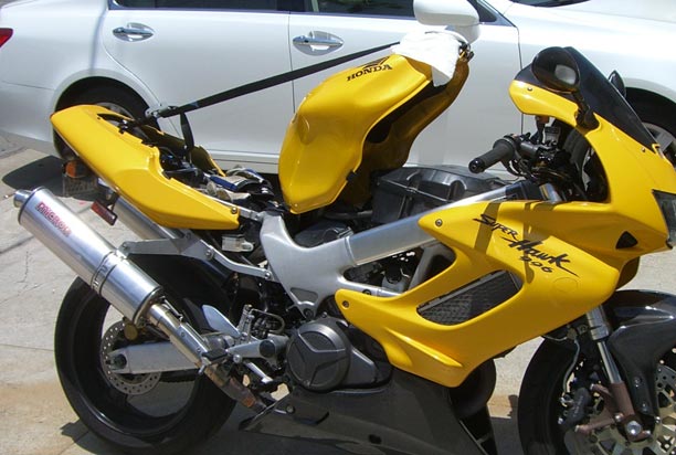

Personally, I don't use that U shaped tool. It seems like an accidental bump of the tank could have it slide off the bike. I remove the two front bolts and just loosen the rear bolt, but leave it installed. Then use a tie down on the rear frame and a link that runs through one of the bolt holes in the front of the tank.
Old Nov 24, 2009 | 01:02 PM
avramd's Avatar
Posts: 143
From: Newport, RI
avramd is on a distinguished road
Cool - does that always give you enough access?
Old Nov 24, 2009 | 01:34 PM
Gregw's Avatar
Posts: 1,031
From: Los Angeles ish
I've pulled the carbs out of their boots and changed the needle settings several times this way.

Greg, I like the idea, esp since I keep mine full, so I'll need to pinch the overflow line. Thanx.
what happened to the pic? I'm glad I saw it. Awesome idea and it works great. I put a little rubber cap over the shock bolt to protect the tank and lifted it. Sturdy as hell. Thanks for posting your idea.
Old Dec 15, 2009 | 04:22 PM
nath981's Avatar
Posts: 2,934
From: altoona, pa
I want to express my appreciation for this great method of lifting the tank. It so easy. Awesome. Made syncing the carbs so easy. Didn't need a special tool to turn 7mm screw to sync carbs; just reach in there with an open end wrench and turn. It is rock solid and makes removing/installing tank hoses a snap. Tank was full of fuel too; just had to put a little plastic bowl under the overflow tubing. Thanks for sharing this.

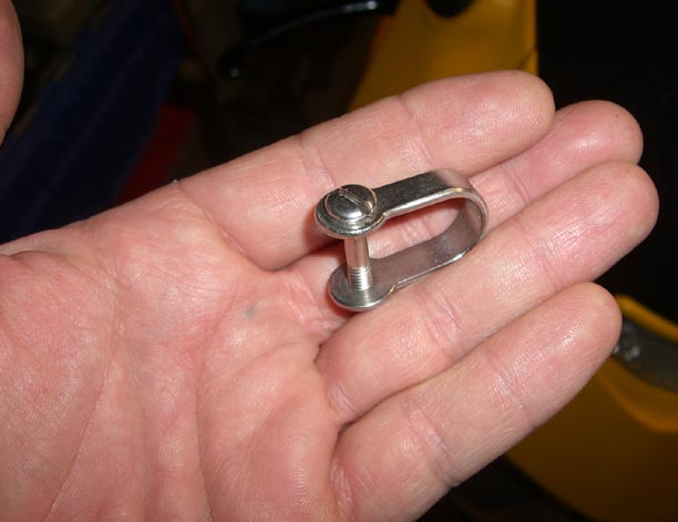

can you provide any more specifics on the link you mention for the front?

A bungie cord doubled over (one hook through each bolt hole) works great when lifting the tank front and tying it up to rafters in the garage. Not so sure about tying it back at the subframe though... you would definitely need to put a towel or something soft between the backs of the hooks and the tank at the very least.
I use one of these since I have a few inna garage. I put the U around one of the holes where the tank bolts to the frame. Then feed the screw from the top and tighten it. That is just one way. You could probably use an eye bolt with a nut, or maybe a piece of rope. As Angry mentioned, you'll want something to protect the tank from scuffing. I used a towel that you can see in the photo. Another thing to keep in mind is not putting too much tension on the tie-down. You don't want to tweak the tank tang.
the strap works like a charm. I used elec tape for the hooks and a piece of foam rubber under the strap at the front of the tank.
I don't know why we keep losing the pics, but anyway a small ratchet strap works great. You have to how to hook up the strap in the ratchet so that you can do a quick release with the right hand while you hold the front with you left hand. I can explain if anyone doesn't know how.
Thanks Greg W - since there is over a foot of snow pending arrival tomorrow, I hope to spend quality time in the garage where I have my hawk, my TV, emergency beverage fridge...
