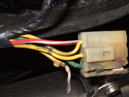

Per superblings write up i replaced my fried stock finned RR with a GSXR unit...off of an 04 600. worked great exactly how he wrote it up (thanks for the great write up!)
off 13.06
high idle (1600) 14.22
at 5000 13.9
do these sound about right? reason i'm asking is bike was jetted, then the RR took a dump i replaced the RR with the GSXR unit and now it's not running right. I'm 98% sure that it's the guy that jetted it didn't dial her in (due to the RR taking a dump in the process of him jetting it.) and would like some opinions before going back to him.
thanks
andy
Attached Thumbnails replaced RR with GSXR unit do these voltages sound right?-2007_1118friedrr0066.jpg
Old Dec 11, 2007 | 02:17 PM
andy9743's Avatar
Posts: 310
pic of old RR connector...
