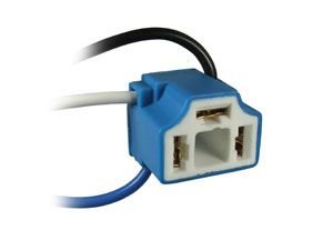

I upgraded mine with Eager Beaver relay kit, ceramic bulb holder and a decent conventional bulb.

Can you give me some info on the ceramic bulb holder you choose?

A ceramic H4 bulb holder with side wires (rather than rear wires) fits as space is at a premium. And I carefuly soldered it in to replace the stocky nylon one that can get frazzled.
