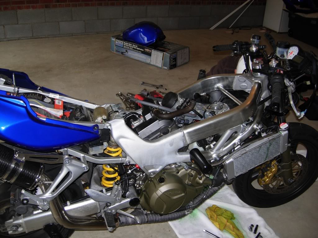

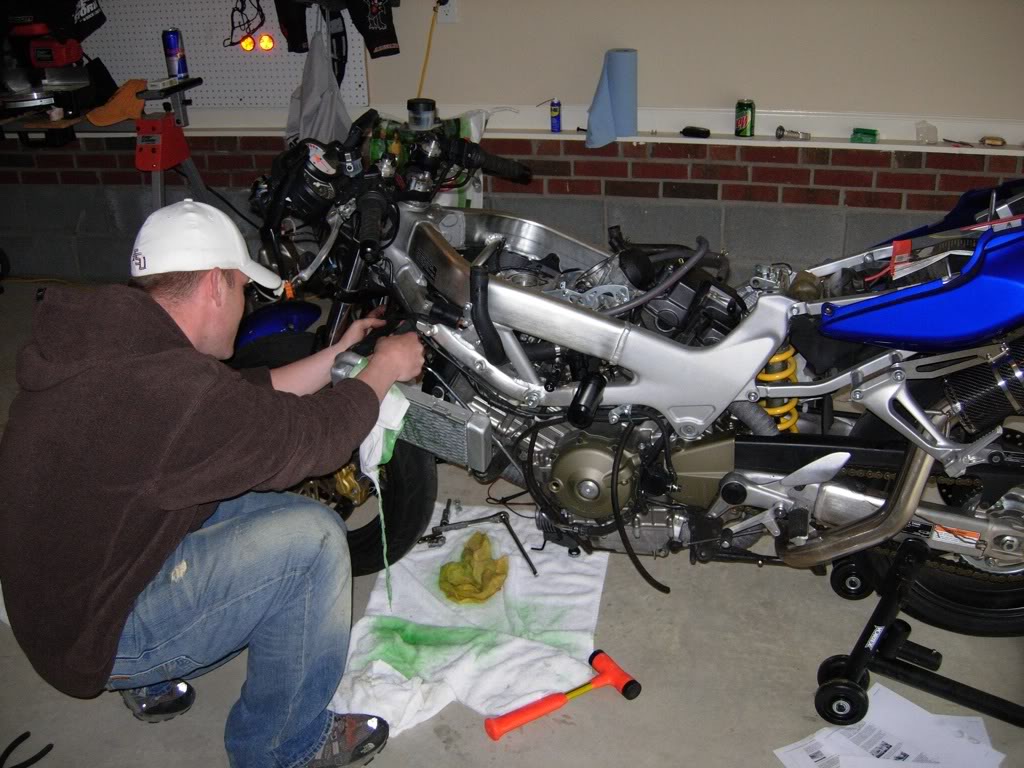

It was raining this past weekend so I decided to tear the bike apart for a few long overdue projects. All together it took under 3 hours with the help of my buddy "Lunchbox", that's him in the pictures.
Installed APE CCT's
TPS MOD
Checked valve clearance
If you look in this one you can see the new CCT on the back cylinder.
The front cams are a PITA to get at.
But not impossible
The backs are much easier. Make sure the LOBES ARE UP!
TDC all lined up.
TPS, didn't have to take mine off, it already had screws in it.
This pic is upside down, the pins you want are the top two, or bottom two on here.
