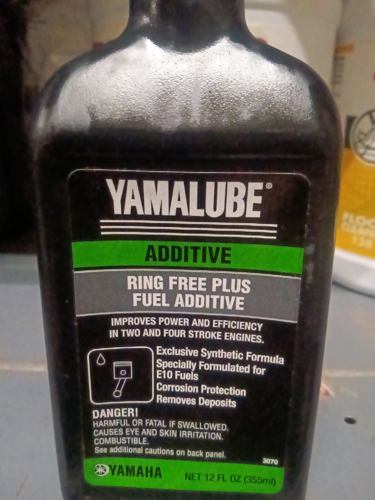

Long shot but the bike shop boss used this a couple times when I worked there. If there's any change an oil ring got stuck to the piston, try some different oils, maybe this ring-free product. You can use seafoam in the oil before a change to try and clean some gunk out.
