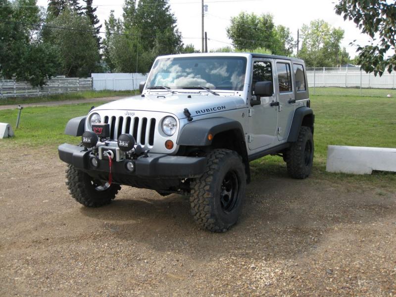

I am going to try the bead balancing with the new tires. I have used them on my Jeep with no probs. (35" TSLs)

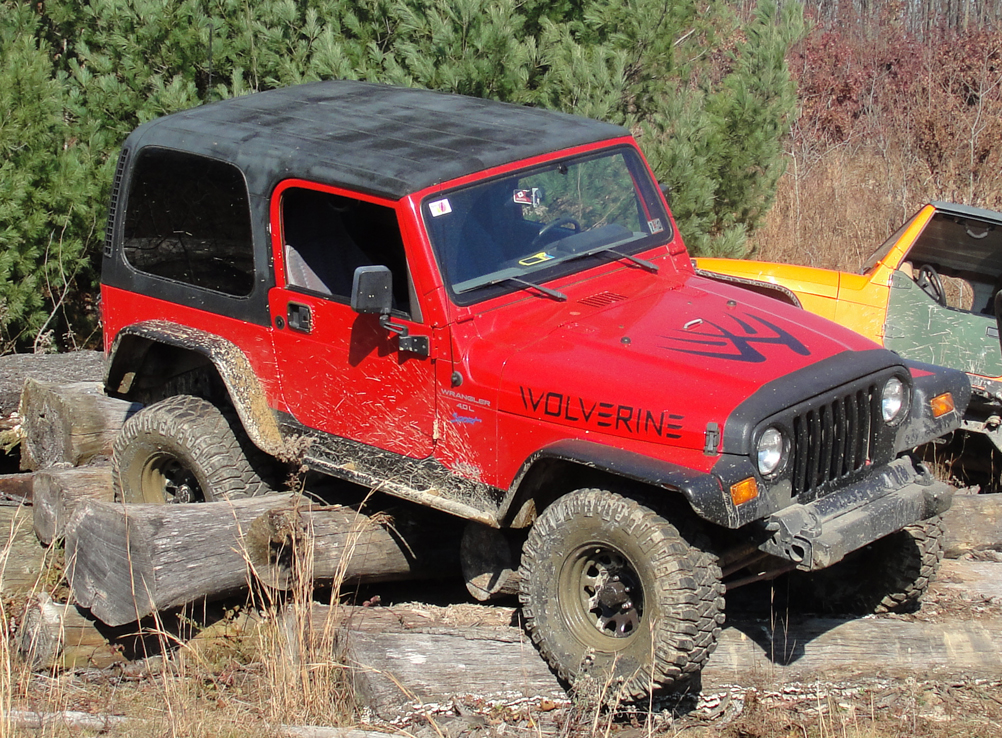

Nice thread revival!! Pics of the Jeep or it didn't happen. Here's ours:

A very good friend used Dynabeads on his Jeep as well. It isn't easy to balance these heavy mud terrain offroad tires. When one is out of balance, you know it immediately. Ours have several weights per tire. The beads worked fine for him. I rode in the Jeep on the highway and can confirm, they did in fact work. BUT, I've never tried them on a bike.
Here is my beast, sorry about the thread hi-jack.
I have been reading more and more about people using beads on their bikes with good results. I don't race so I am going to give them a try as well.
