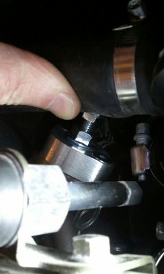

front vs rear
SO, I ordered the Krieger CCTs.
I got them installed...and read a ton of the "feel/finger tight" posts....
I think I'm past that now.
Getting everything back together, and I look at my work.
Are the krieger ccts different when you buy a set?
Is there a front vs rear?
The front has about 4 threads showing between the locknut and the upper/top nut.
The rear has 22-23mm of exposed threads?
The OEM ccts look like the same distance from the mount to the top of the adjuster.
Is that right/normal?
Old Apr 14, 2012 | 08:44 PM
Spoot's Avatar
über-n00b
Joined: Dec 2011
Posts: 257
From: S. WI
Spoot is on a distinguished road
oops. found another thread....krieger ccts have one short and one longer.
AND....looking at the directions from KRIEGER...it mentions one longer and where to put them. (I was following the directions form the famous PDF)
short one should go in the rear.
longer in the front.
SO.
Since I believe that I still got the "feel" right...and I had just enough thread for the locktight before screwing it in....I'd guess I should be OK?
