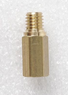

the old bird is running a bit lean so got some bigger mains on a site
and they had different jets on the site pictures, also keihin but with the hex head the long ones,
so i called them.... will i get the right jets he yeah you typed in firestorm so you get the right stuff...... you guess it the wrong ones,
they are the hex head type see attachment,
float bowls fit and thread is the same
but the question is will it work ?
grtz RoadManiac

Short answer no!

+1
You want Keihin N424-36 jets.
OVERALL LENGTH = 8mm
HEAD DIAMETER = 6mm
THREAD DIAMETER = 4.9mm
www.jetsrus.com/a_jet_kit_street/honda_1000_VTR1000_super_hawk.htm
