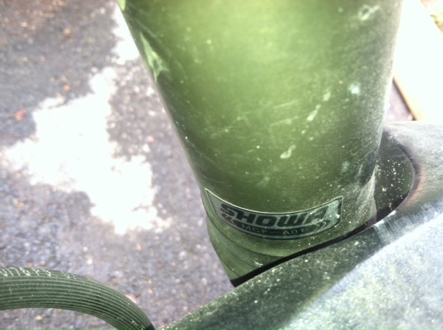

My Vtr was previously altered before owning it and i am slowly learning all of the different "modifications" as i tear into her. I have upside forks on the hawk and they are showa brand. the sticker near the front wheel reads showa "MCF-A01" any ideas? I also need the diameter of the upper fork tubes to buy or make mounts for my dominator headlights.

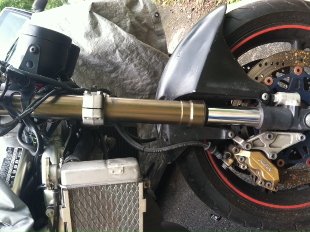

Old Aug 11, 2015 | 10:24 AM
Rebirth98's Avatar
Joined: Jan 2013
Posts: 87
Rebirth98 is on a distinguished road
This is always true
Attached Thumbnails Identify USD forks?-fork-pic-1.jpeg   Identify USD forks?-fork-pic-3.jpeg   Identify USD forks?-fork-pic-2.jpeg
Old Aug 11, 2015 | 10:31 AM
Look like RC51.
Old Aug 11, 2015 | 01:30 PM
killer5280's Avatar
Joined: Aug 2004
Posts: 1,806
From: Atlanta, GA
Look like RC51.
That's what they look like to me, too.
Old Aug 11, 2015 | 02:03 PM
Jack Flash's Avatar
Well take off, eh.
Joined: Jun 2012
Posts: 1,206
From: QC, Canada
RC-51 it is. The caliper bracket is the give away.
Old Aug 11, 2015 | 02:46 PM
Cadbury64's Avatar
VTR virgin
Joined: Mar 2015
Posts: 448
From: Auckland, New Zealand
MCF is the part code for the RC-51.
Old Aug 11, 2015 | 05:50 PM
Rebirth98's Avatar
Joined: Jan 2013
Posts: 87
you guys are money. Anyone have off hand knowledge of upper fork tube diameter so i dont have to hunt down a micrometer
Old Aug 11, 2015 | 08:39 PM
killer5280's Avatar
Joined: Aug 2004
Posts: 1,806
From: Atlanta, GA
Here's a link to a little chart someone put together, but, like the webpage says, be careful because upper fork tubes can taper in and out.
Fork Tube Chart
Old Aug 11, 2015 | 09:37 PM
50 same as CBR1000rr

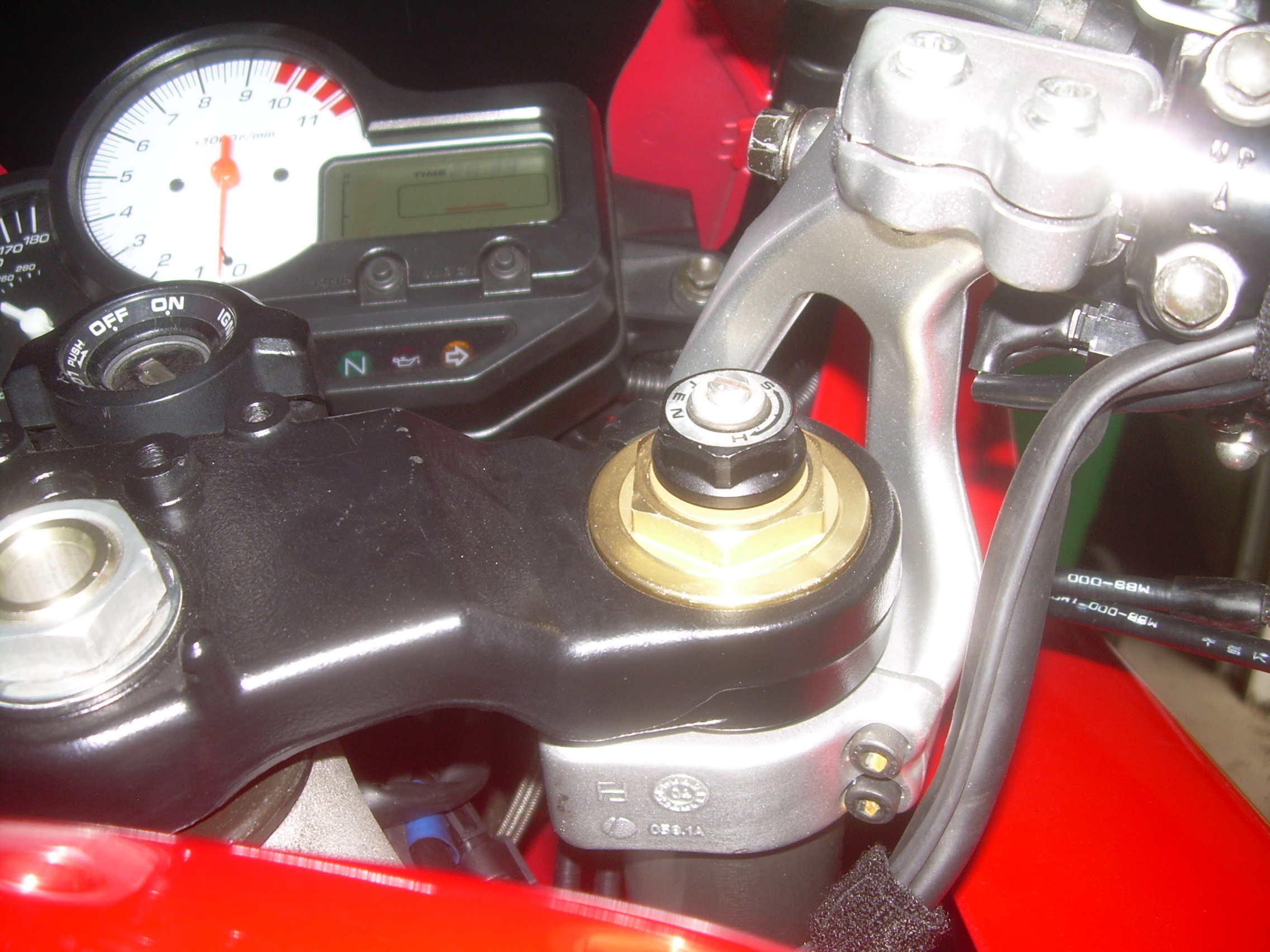

Old Aug 13, 2015 | 09:31 PM
Joe, I measured the risers, I have 3 inches above the upper triple tree
Attached Thumbnails Identify USD forks?-dscn9431.jpg   Identify USD forks?-dscn9432.jpg
Old Aug 13, 2015 | 09:49 PM
NH, what year are they and why cant I find any on ebay? They look to be what I need for my front end swap.
Old Aug 13, 2015 | 09:57 PM
That was from an 07, probably not too many of them, but keep an eye.
