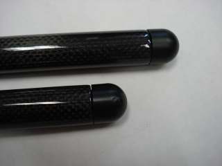

I dont want highjack this thread, but Micky, maybe you can shave a few more grams by replacing your Helibar tubes with these CF tubes...lol
Looking at the Turntech website it looks like they charge 40 bucks more for european customers, for the same battery - plus shipping. That dont make any sense to me.

Don`t get me started Peter.... In so far as the Turntech battery is concerned, if you want one let me know and I can save you $40....
